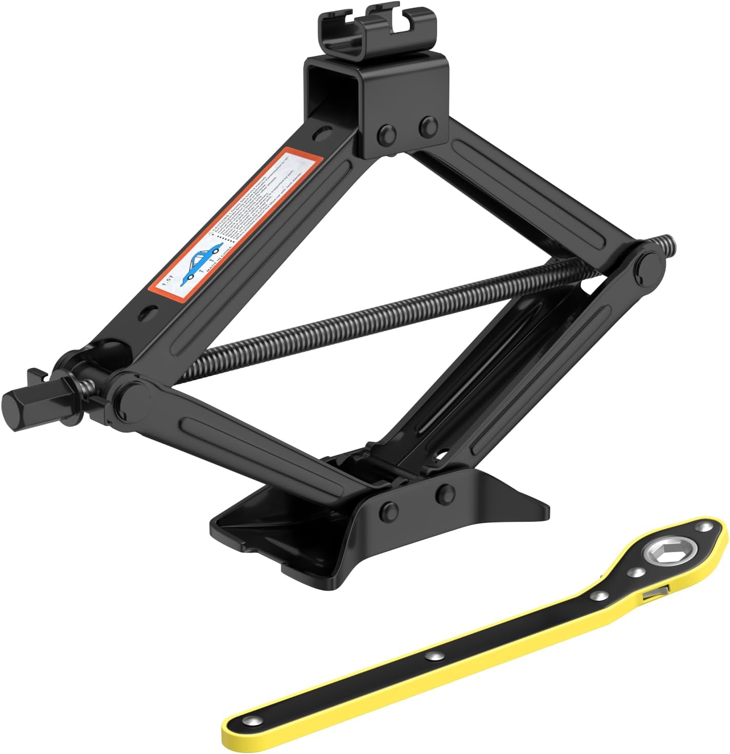

    For oil changes, I am unfortunately highly space limited in terms of storing a floor jack. And the gen5 is far too low to crawl under. So here is my question: is it ok, acceptable, good to use a $30 scissor jack off amazon (like below) to, for example, lift the right front of the car, put in a jack stand, and then lower the car. Then, lift the left front of the car, put in a jack stand on that side, and lower the car? With the rear wheels chocked, of course. Any thoughts if this an ok strategy?

    That can work, have done it myself. But those are substantially less stable than hydraulic floor jacks, and they make you work harder.
    You should be aware that those are considered to be for emergency tire changes only- they aren't really expected to be used than a handful of times. If you've got a very stable level floor or driveway you can stretch it a bit. Forget it if there's a slope or crown to the surface, that just multiplies the risk of tip-over.
    If it were me, I'd be using that as notice that I just don't have good enough of a garage situation to do my own oil changes at home.

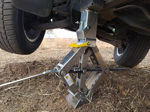

    Those scissor jacks can be downright scary and unsafe, especially when used in the manner you propose, where you are using it to lift the opposite side of the car already on one jackstand. The reason is that the standard scissor jack doesn't resist twisting/torsional forces that lead to the jack collapsing to the side.
    I have been giving a lot of thought to how to perform oil changes, differential drain/fills, and CVT transmission drain/fills on my son's cars in a space limited apartment garage.
    The cars have really low ground clearance at only 5 inches and the front central jacking point is way back.
    I plan to use very low clearance short ramps with a 2.5 inch height to just raise the front of the car enough to get the jack under the central jacking point. Then I will place 2 jackstands under the front pinch weld jack points with appropriate adapters.
    Then for maintenance requiring the car to be level, I will jack up the rear from the central jack point and place jackstands under the rear pinch weld jack points.
    The jack I have decided on is an extra heavy, overbuilt scissor jack that is made for offroading/overlanding enthusiasts. It is conservatively rated at 2 tons, but it has been tested for much higher loads without failing. It is purely mechanical, so no hydraulic oil to leak in their apartment, should a seal on a floor jack start to leak.
    It should be much easier to transport up and down to the garage from their apartment using a crate and 2-wheeled luggage cart vs a heavier wheeled floor jack.
    Here is the jack I plan to use:
    GORTECH Heavy Duty Scissor Jack for Car, Heavy Duty 2T (4,400 lbs), Car Emergency Kit for Tire Change and Repairs, Auto, Car, SUV, RV, EV, 4x4, Truck, Trailer, Overlanding, Car Lift, Electric Jack https://a.co/d/dPVCK36
    There's more images and a short video at this link:

    One of the reasons a floor jack is on wheels is to allow the jack to move as the lifting point moves through an arc, typically, as the side of the car is lifted and the opposite side of the car is fixed.
    The GORTECH scissor jack claims to be able to accommodate the movement of the lifting point as it moves through the arc while lifting. I'm not sure if it's due to a flexible base connection or such, but that's the claim.
    Standard scissor jacks have fixed, rigid bases that do not move as the lift occurs. This can put side loads or twisting forces on the jack at the base and arms.

    Don't care for it. A rolling jack keeps the downward force pushing perpendicular to the ground, and jack base under the load.

    Yes, that is a limitation of this type of jack. I'm not going to be doing really high lifts, so I don't think it will be much of a factor.
    I did mention that I would be primarily using the two central jacking points, front and rear, so the arc of the lifting point along that axis of the car will be longer than lifting from the side, which would have a much shorter axis/arc of movement.
