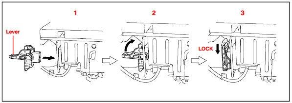

    You measured 12.7V at the jump points under the front hood?
    Did you lock down the orange safety switch?
    Though it may not be related to why the vehicle stopped running (those codes are gone), best to follow the obd2 codes that you have now. The FSM workups below are a bit dated, but may help. Also double check your HV rebuilding work, as you may have missed something.
