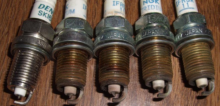

    The maintenance schedule called for the plugs change at 120k or 150k miles. So, 200k is a bit of a stretch. Do you still have the old plugs? I'll be interested to see the condition.
    I changed my 2006 Prius plug at 113k miles and they looked like this (left Denso is new). The gas mileage may have improved a little (0.5 or 1 MPG?) but it was barely noticeable, suggesting the plugs still had life.
