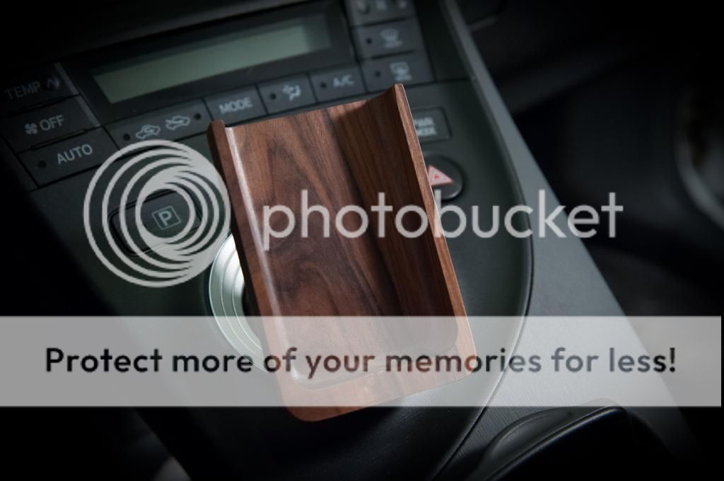

    I finally got around to making an iPhone cradle for my V (non-Nav). I didn't want to drill holes, use up a cup holder, or intrude into passenger space. It had to put the iPhone within easy reach, and had to be sturdy.

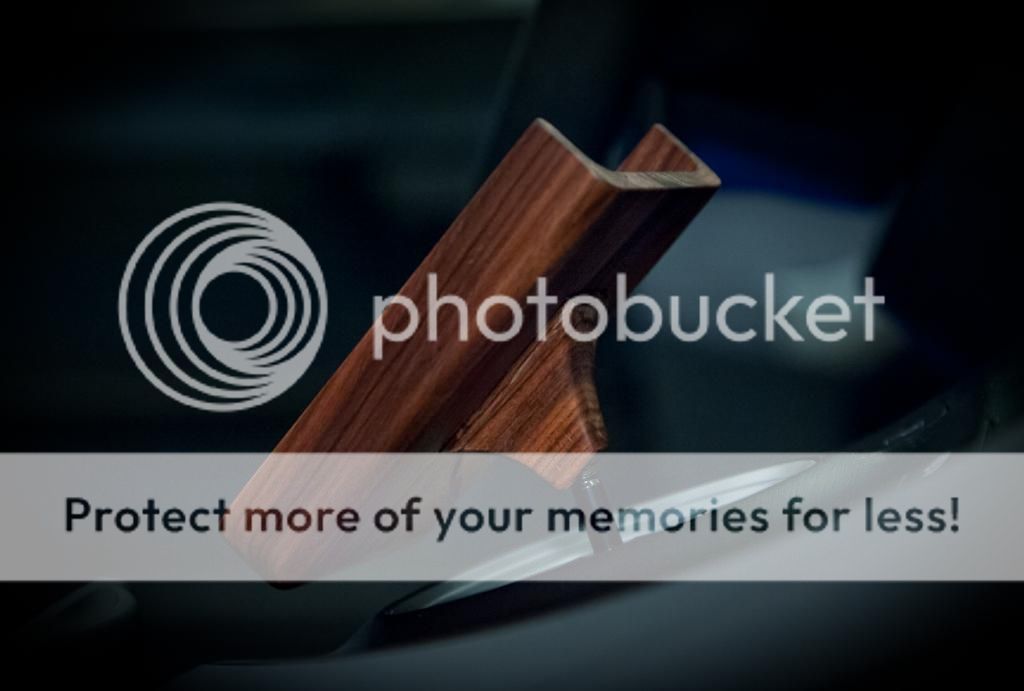

    It took me so long..........until I figured out the key was to replace the shifter knob with the cradle. I unscrew the shifter and took note of the stem size and thread. Found its equivalent in a hex bolt in my collection, so I gauged drill size and use the bolt to thread the wood before installing in car.
    I cut a piece of cedar and drilled a hole on the underside with a slight tilt towards me. Cedar is soft, so if it gets loose, version 2 will be walnut.
    I thread it on and made sure there is enough clearance to still work the shifter. It feels sturdy.
    Cable mgmt is in progress. I have to get a right angle 3.5mm stereo jack to tuck things in better. I might use the USB under the bridge instead of inside the centre armrest.

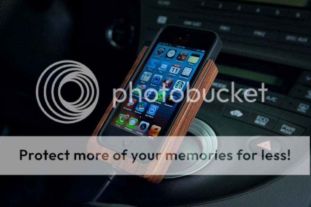

    Here is my 3rd and final version. The 2nd version used a single 30 pin cable for both power and audio. Separate cables were such a PITA. It looked the same, and I wanted more. Using both hands to unplug the cable grew tiresome so I modified the cradle. I kept the same piece of wood and I permanently fixed the cable jack so it acts as a dock. Now, I can dock/undock the phone with one hand. Makes getting in and out of the car less of a chore. I rounded the corners and finished it off with matte black paint. I tucked the cable between the bottom of the bridge, between the top cup holder and the flanges of the centre console. This is the best compromise between the need to manage music and info, ease of use, USB power, sturdy installation, and totally reversible.
    Disadvantages:
    1. Cradle is made to fit the external dimensions of the iPhone + case. Will not accept a change in case or multiple phones.
    2. armrest cannot close completely, but very close.
    3. not "factory flush" install.
    4. requires woodworking tools to make. Table saw, drill press. A router would be nice but I don't have one.

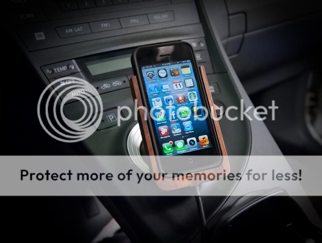

    So I got the i5 so it was time to make another shifter cradle for it. This time, I used Pau Ferro (a South American hardwood) and I bought a router. The router was used to mill the slot out of one solid piece of wood. The foot was shaped with a dremel and glued on. I settled on a bigger tilt than my last iteration. Although I love the grain in Pau Ferro, I liked my black version as well. I just don't have the heart to spray paint such nice wood (yet).
    Just like my last one, it requires no permanent modification to my car and allows normal shifting. I tucked the cable behind the lid of the upper cupholder. I can't close the lid but I never close it anyway. My 2010 Prius V has the JBL and no Nav, so I rely on the USB for power and 3.5mm jack for audio. The lightning to 30-pin adapter fits onto a 30 pin to USB + 3.5mm audio combo cable. I'm not sure if I want to hide my phone and BT stream audio anyway. I like to manage songs, answer short texts, and receive notifications. As controversial as Apple's Maps is, I'm sure it's better than Toyota's Nav. Turn by turn navigation is heard thru the car's speaker and cuts out music appropriately.

    I have a MDL II, and I wonder why you use the audio cable connector and not just the USB into the dedicated USB for the iPod/iPhone input? I like the idea what you have there.
  18. Much More Better
    Much More Better Active Member
    Nov 2, 2009
    655
    163
    Because my 2010 does not support USB audio. I get power from USB, that's all.
