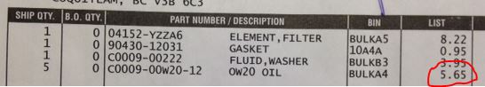

    Our nearby dealership's parts department sells liters of Toyota 0W20 for under $6 a liter. Maybe check with yours before searching further afield? They also have the filter, replacement drain bolt washer, obviously.

  11. Mendel Leisk
    58,962
    40,584
    Not for the Toyota oil. This is from my last invoice, Open Road Toyota:
    And this is liters. The other's are often quarts (a bit smaller), and yes, way too expensive. Toyota's oil is fine.
