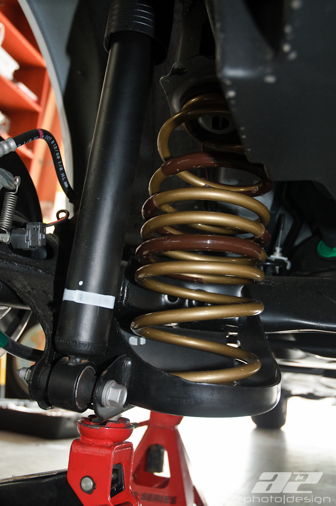

    Rear Suspension:
    Step 1: Jack up the rear of the car via the jacking points. Make sure the front wheels are secured so the car won't roll anywhere.
    Step 2: Take both rear wheels off to gain optimal access to the rear suspension components.

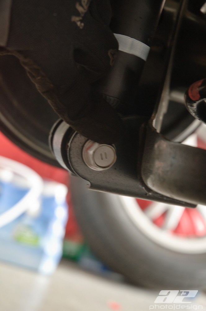

    Step 3: Use your 17mm socket and 1/2" drive breaker bar to remove the
    nut that holds the pin to the bottom of the rear struts.

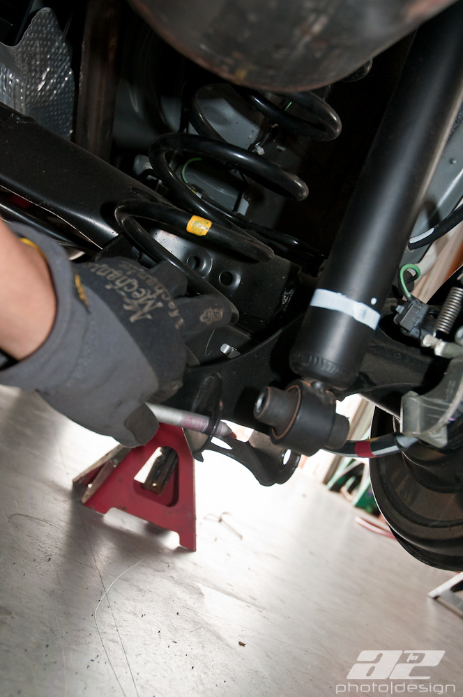

    Step 4: Pull out the bolt that holds the lower strut assembly to the beam suspension. You have have to use your jack to relieve pressure off the bolt in order to do this. Do this to both sides before continuing or else you won't be able to easily complete step 5.

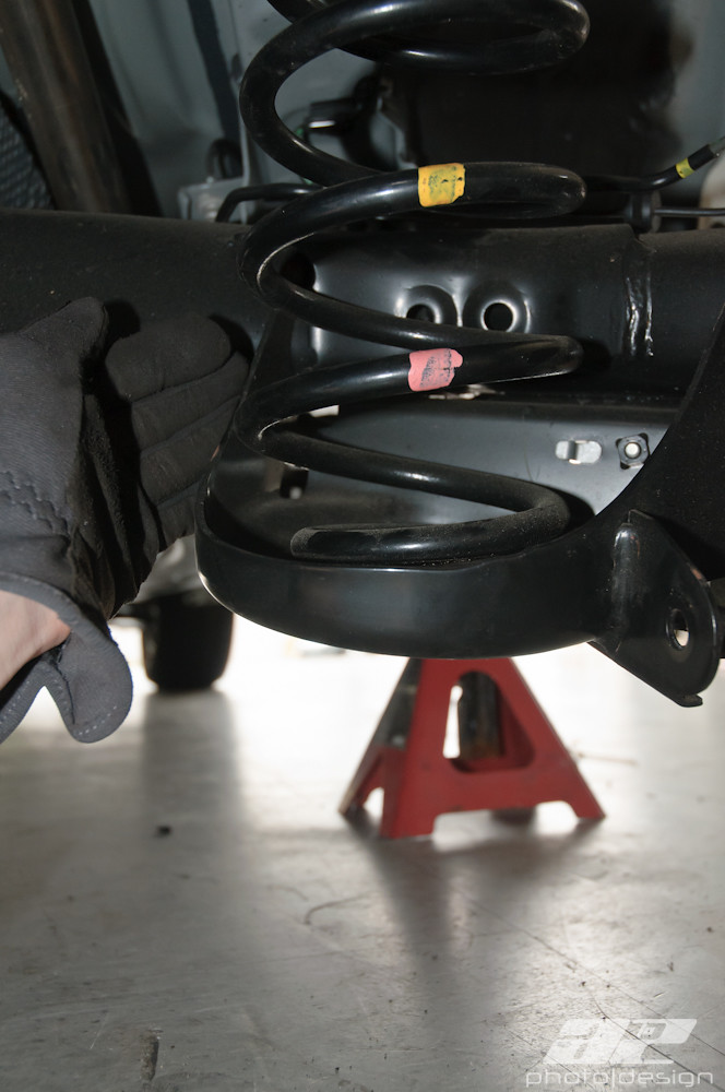

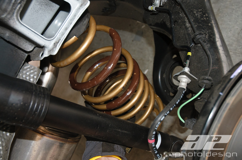

    Step 5: To remove the spring from the perch, you'll have to pull down the beam enough to pull it out or have a buddy step down on the brake assembly enough for you to tug out the stock spring.
    (spring removed)

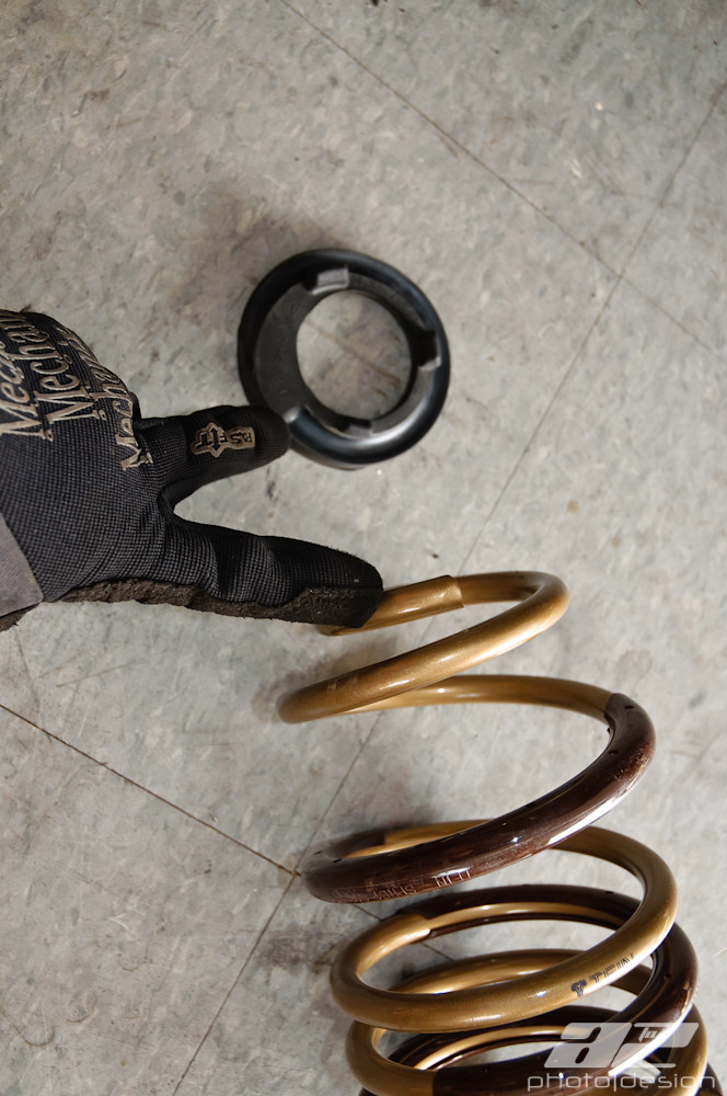

    Step 6: Take note of the way the spring came out of the perch and look at the way the grommet mates up with the spring.

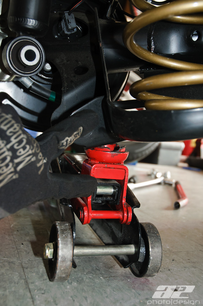

    Step 7: Place the top of the new spring onto the mount on the car and push down the beam enough to fit in the new spring. Repeat for opposite side.
    Step 8: Position your jack underneath the beam so that you can jack up and compress the spring enough to reattach the bolt onto the lower strut.
    Step 9: Reattach the nut onto the bolt and tighten firmly. Put your wheels back on and tighten the lugs then lower the rear back onto the ground. That's it for the rear! :eek::rockon:

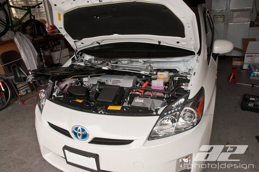

    Here's what the engine bay will look like after the removal of the plastic cowl.
    Step 3: This is where we'll need to remove the wiper assembly and tray in order to reach the top mounts for the front struts. Use your 10mm socket and various extensions to remove these bolts. I recommend first removing the 4 bolts that hold the wiper assembly to the metal tray and then position that assembly on top of the HSD cover. Then you have easy access to the rest of the 10mm bolts. Take note of how the bolts of the wiper assembly differ from those of the tray.

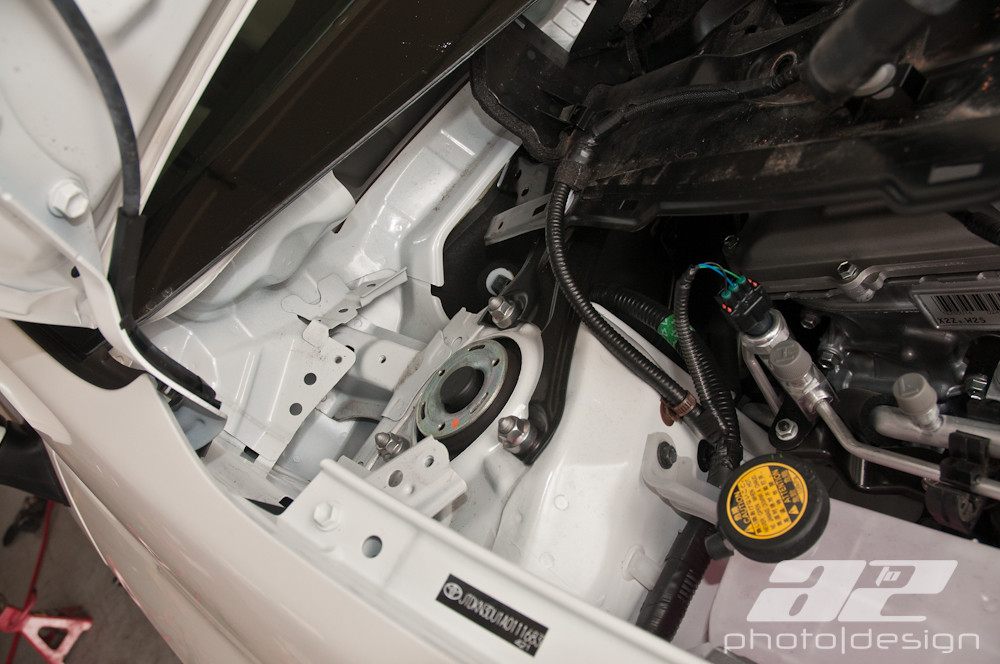

    Step 4: After you have removed all the bolts, position the tray and assembly motor in a way that you can access all 6 of the top mount nuts.
    Step 5: Break loose the nuts for the Driver and Passenger top mounts but don't fully remove them.

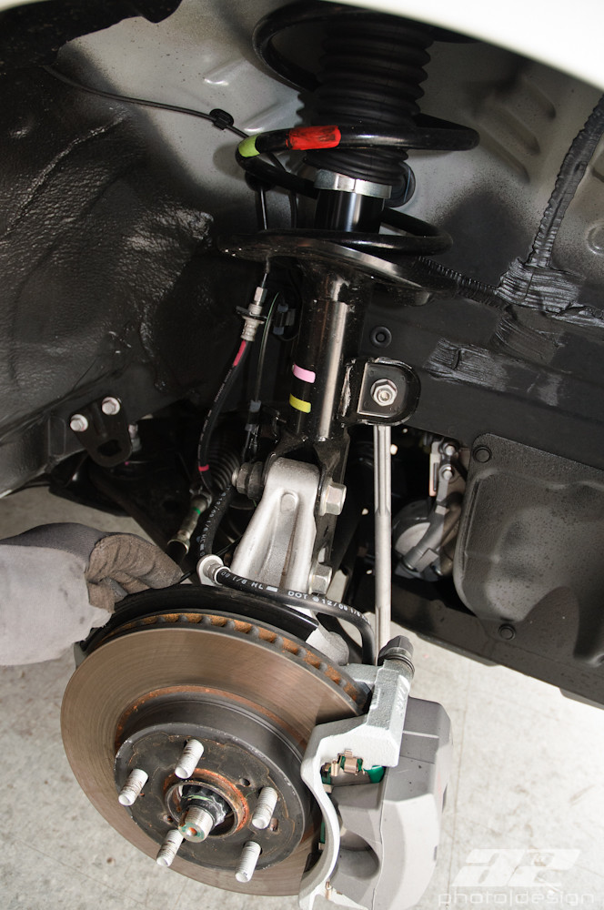

    Step 6: Jack up the front of the car and take off the wheels. You'll now be looking at the strut assembly and front brakes

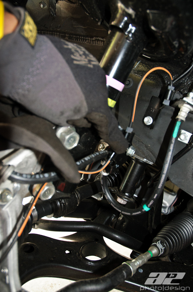

    Step 7: Use your 12mm socket to remove the bolt that holds the brake sensor and brake line to the strut. Also use your flat head screwdriver to undo the plastic snap that holds the brake line sensor to the strut just behind the two large bolts.

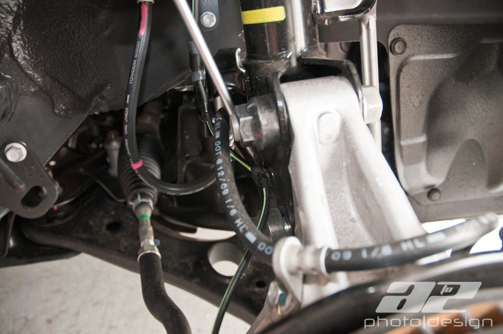

    Step 8: Use your 23mm socket and breaker bar to remove the two main bolts that hold the brake assembly and control arm to to the strut.
    Step 9: Use your 17mm socket to remove the bolt that attaches the sway bar endlink to the strut housing.
    Step 10: Undo the top bolts and remove the strut assembly from the car.

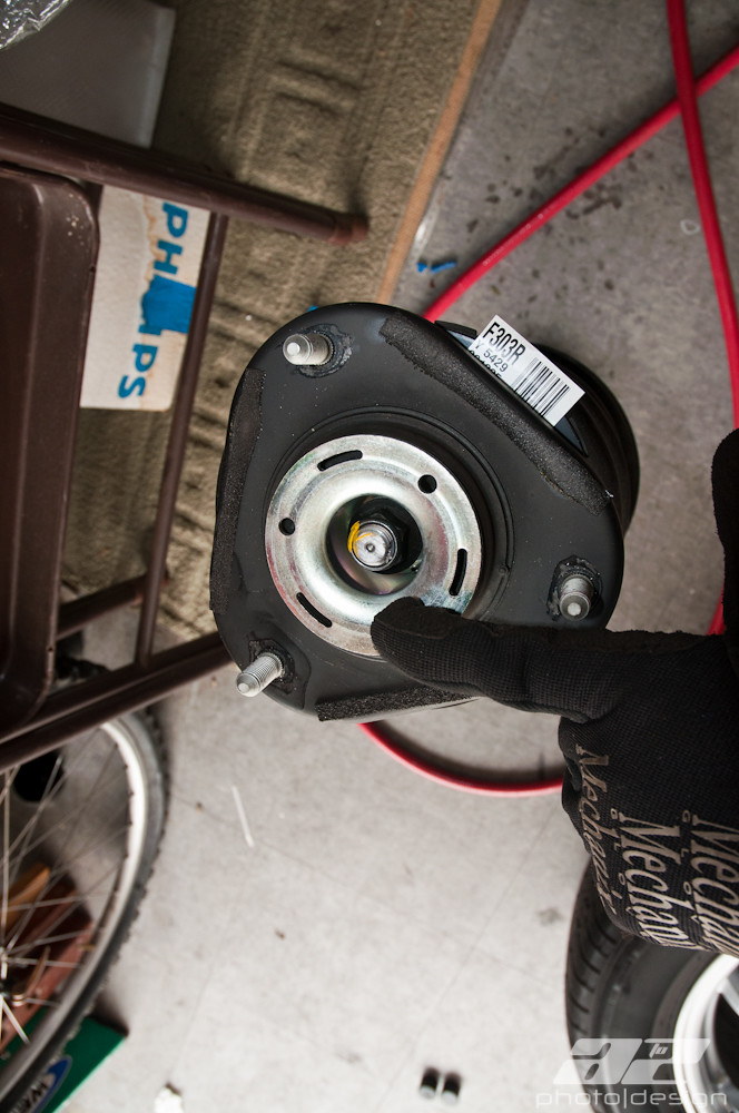

    Step 12: Locate the 19mm nut at attaches the top mount to the strut and remove it.
    Step 13: Take apart the strut assembly taking note of the order of the parts (sorry I should of snapped a shot of this but I forgot)
    Step 14: Place your new spring onto the strut and compress using the spring compressors enough so you can reassemble the strut and tighten the top mount to the strut.
