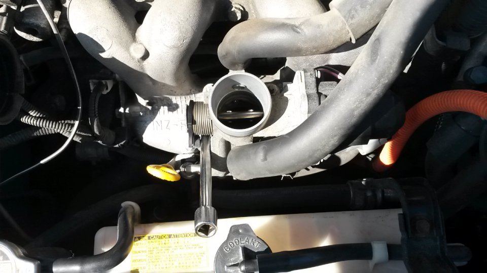

    Here's how I clean the throttle body. I remove the air filter box, Turn the throttle knob, and place an extension in to hold it open. I then spray inside the open throttle body with throttle body cleaner and wipe with a clean rag. Here's a pic.
