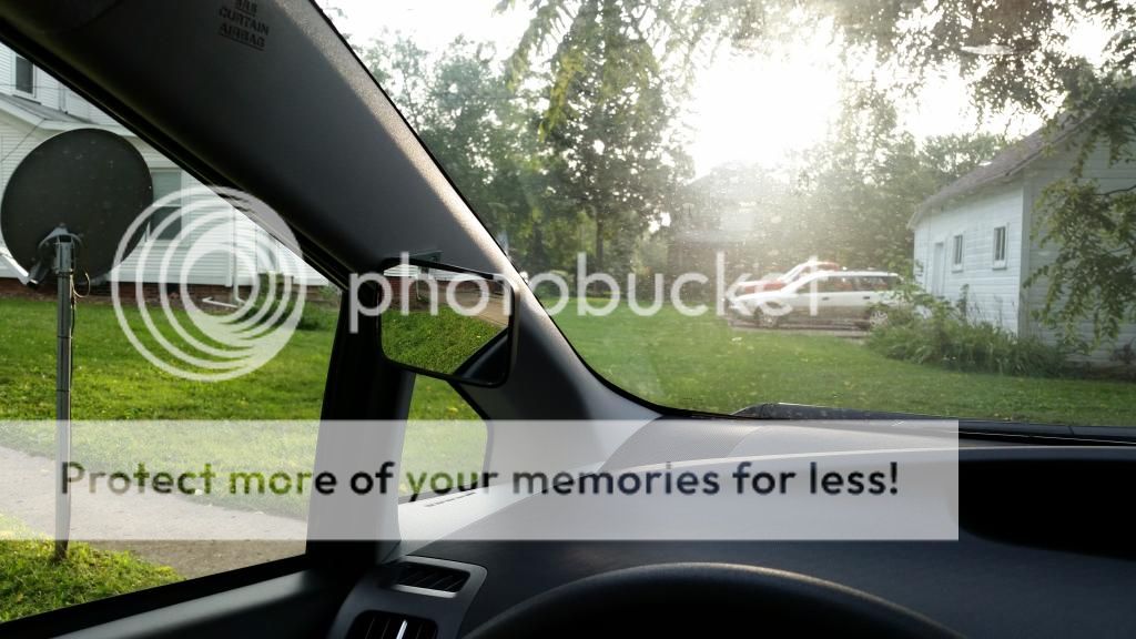

    I've removed the passenger side mirror, and only recently put the driver side mirror back on the car for some upcoming road trips through states that require it. Most states do not require exterior mirrors at all; a small convex mirror mounted on the A-pillar will eliminate any blind spots if aimed properly and is much cheaper and easier to set up than a camera system. You can check your state's mirror laws on the Ecomodder Wiki (should come up on a simple Google search).
    I've been using this setup for the past year and a half:
    Robert Holt likes this.

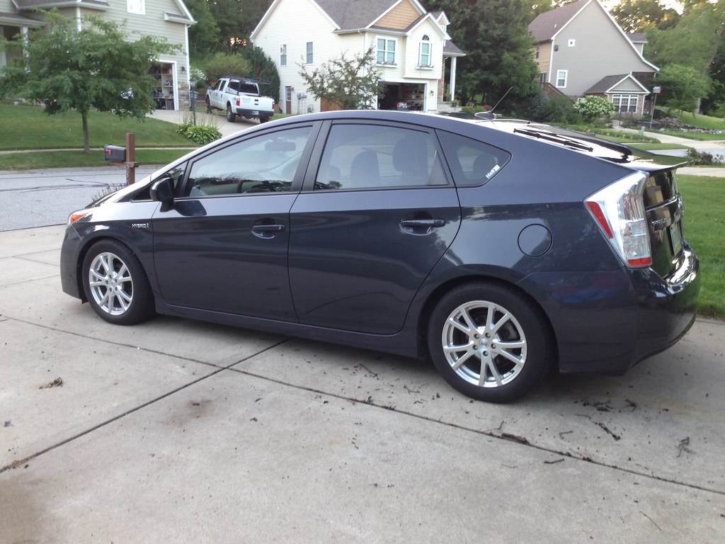

    I used the H&R Sport Springs to lower it a bit and it seemed to help ever-so-slightly in the mpg department. Probably wouldn't have done it if I hadn't been doing the shocks/struts. Honestly though the ride didn't seem any worse than stock. Plus it looks a lot better (imho), and the handling is definitely improved. Makes on/off ramps much more fun. :)
    [​IMG]Untitled by Ryan Kokesh, on Flickr

    I'd be worried about having a mirror explosively launched into my face by the airbag right behind that pillar.
    Otherwise seems like a great idea for reducing frontal surface area.

    Alternatively, you could mount a mirror to the top of the door panel, right next to the window, but you'll need something more complex than a simple L-bracket. If I take the driver's mirror off in future, I'll probably go that route.
