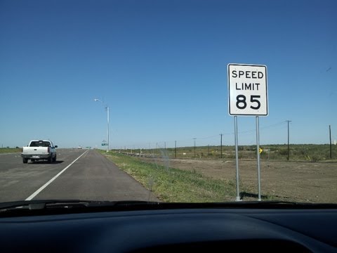

    There are some places on the globe where people are not shackled with relatively low speed limits, and in at least one of our more progressive US states....there are areas where the speed limit IS 85.
