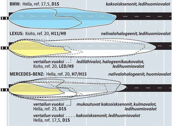

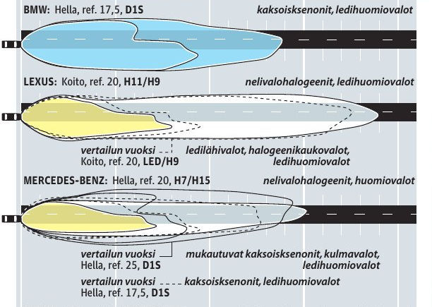

    Okay. That cap with led headlights is interesting, beam patterns seem normal for pre-facelift model. Dashed line is the led for CT.

    That doesn't look very good. Did you ask dealer to check lamp alignment? I'll get back to this when/if I get the car.

    As you can see from these 2 pictures, it's because of the way Toyota designed the LED lenses. Together, they create a break in the pattern at the center, which looks awkward on the road, and hides part of the lane to your left.
    [​IMG][​IMG]
    A Lexus diagnostician suggested that he could raise the alignment a bit to shoot the light further down the road, because the standard alignment is already well within tolerance for US regulations. The service director at the dealer told me that every car he's seen with LED lights, which usually comes with auto-leveling headlights (as CTs do when they have LEDs from the factory), will ignore any adjustments to the alignment and auto-level themselves the next time the car starts up. This is exactly what happened for me, the car disregarded the adjustments I had them make and now the headlights are back to factory standard. I have to live with it I guess.

    They actually look like they are supposed to. Like the BMW diagram here.
    The low beams on most cars shine less into the oncoming lane to not blind the other driver. HIDs and apparrantly LEDs have less fuzziness to their outlines than halogens. This sharpness makes the intended lit area my obvious to the driver.
