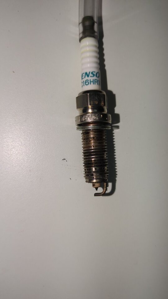

    I'm not sure what to make of these borescope images.
    Does the cylinder look damaged or OK, please?

    Crosshatch is still there, like most. The small vertical lines don't look significant. Why is there moisture (water/coolant?) in the cylinder?
    Is that the right sparkplug or is that a gen 3 plug you're using, it looks like an SC16HR11?
    Gen 2 Denso should be an SK16R11
    I hope like crazy you're not using that gen 3 plug in your gen 2. Holy F.
    SK16R11 gen 2 thread is 14mm and reach is 19mm
    SC16HR11 thread is 12mm and reach is 26.5mm

    Sorry, I'm fussing with two of our 3 Prius's and posted this in the wrong sub-group with the wrong title.
    These pics are from our Gen 3 - 2012.

    Sorry, I mislabeled and mis-posted - it's our 2012. Someone else looked and thought the deposit looked like burned oil.
