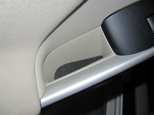

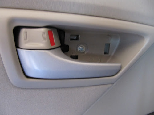

    The door is held in place with 2 Philips head screws and a bunch of plastic clips (below).
    The first screw is located behind a piece of trim behind the door handle. Pull the door handle while you pry the plastic trim piece out.
    The second screw is directly under a piece of foam in that small cubby hole thing. I just gently used a flathead screwdriver to lift the piece of foam up and out.
