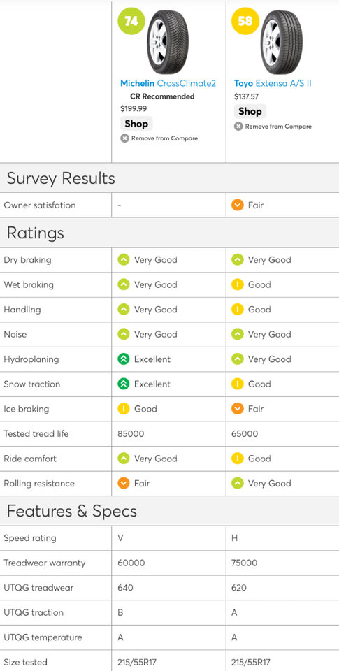

    I haven’t seen anyone on here do any objective testing but here is a screenshot from consumer reports comparing Toyo Extensa A/S II and Michelin Cross Climate 2 both in size 215/55 R17.
