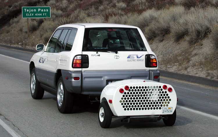

    Owners will regret Nissan putting the charging point dead center in the front. a rear charging point would have made towing a genset easier.
    http://www.evnut.com/rav_longranger.htm

    As far as towing a trailer - that can make some sense. And Toyota was working on just such a thing when they stopped their EV program. More info here: Rav Long Ranger
    I agree that it would be nothing more than a stunt, but I don't agree about negative publicity. Every time it has been done in the past, the general response was very positive. There will always be the grumps.
    Not true. At least not if done correctly. The Rav pulling the trailer was getting about 30 mpg at freeway speeds. That is BETTER than the gas mileage of the gasoline version of the same vehicle without pulling the trailer. Go figure. The reason of course is that the ICE of the genset is only big enough to sustain charge - not big enough to do all the things that a normal ICE has to do. The Rav becomes a plug-in hybrid.
