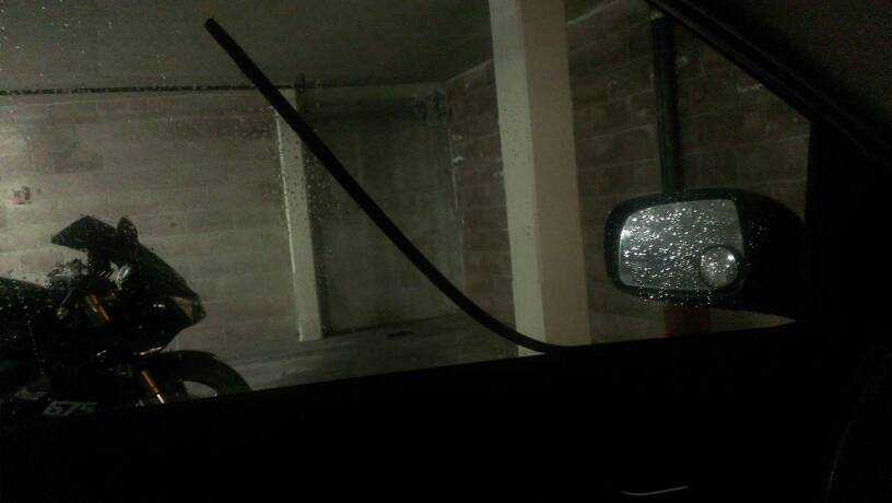

    Thanks!

    Fix: buy new car? Should be easy. Order parts and replace

    Would these be the right part?
    • [ 9 ] BODY HARDWARE / FRONT DOOR / DOOR & COMPONENTS / Surround w'strip
      surround w'strip Left
      [ 10 ] BODY HARDWARE / FRONT DOOR / DOOR & COMPONENTS / Surround w'strip clip
      surround w'strip clip type 1 Left
      PARTS: Part included with surround weatherstrip.
    • Here's the diagram 2007 Toyota Prius Parts - AutoNation Toyota Gulf Freeway Parts
    #3 ystasino, Jul 23, 2014

    I believe that 9 is the rubber that runs all the way around the door and its purpose is to seal the door when it is closed.
    11 might be the part, but you should call the parts dept and discuss with the person there what you need.

    Thanks Patrick, I did call this morning, they said they didn't have a computer screen and could not tell
