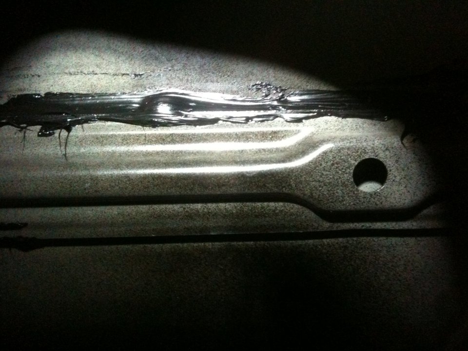

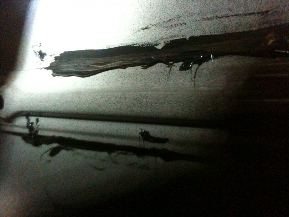

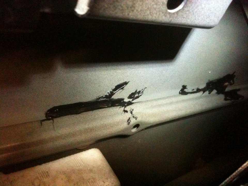

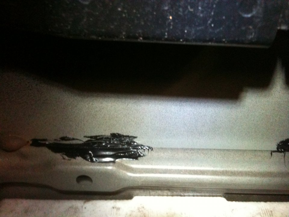

  10. dlthames
    dlthames Junior Member
    Jan 13, 2014
    Northwest Florida
    Thanks for the post Skyler! Between yours and nate358's posts I was able to take the door panel off, peel back the plastic dust guard, and re adhere the stiffening rib to the door skin. I used a 3M product called Superfast Windshield urethane. Now the door closes with a solid thud.
