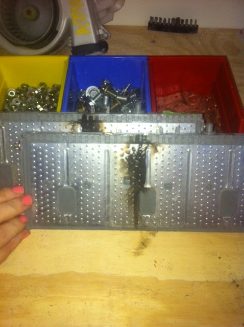

    Here is a picture of some pretty burnt Gen II modules! Pulled these bad boys from an '06 with approx. 120,000 miles on it. The customer drove for months after receiving the battery failure code (due to lack of funds to fix it). These modules came from a block near the center of the pack, as you might have guessed. I have seen some pretty degraded packs, but this one took the cake! I went ahead and put the remaining modules through a few charging cycles and the highest capacity cell was 3400/6000. No bueno!
    Anyhow, I am tempted to take a hacksaw to them as I have never seen inside a module before! Thought I would share the pics though :)

    How does driving after a failed battery cause this?

    I am no electrical engineer, but the way I understand it is that once the module has lost its capacity, it is not able to accept any energy from the regenerative brakes and engine. When electricity passes through a failed module, the energy is converted into heat instead of charging the module. This heat can be great enough to start a fire. This failed block then causes a disruption in the charge/discharge cycle, undercharging the rest of the pack.

    Awesome picture.
    I enjoy seeing this kind of photo.
    Is a good illustration that can be used as a warning for my customers.

    Great pic and I'd expect the burnt modules were because of the climate down being so hot. I've been clearing it on mine for a while too but I will be curious to see if my battery will have lost any significant capacity after cycling the remaining good cells too since my climate is alot cooler than yours.
    Also careful cutting them open because they are full of caustic alkali, besides someone already did it for you........

    Yikes! The burnt modules really had little to do with the climate and more to do with electricity and battery chemistry. Do you know how many bad cells you have? I'm worried that you could cause damage to your car (or worse) by continuing to drive on it... If I can find the case to the battery that caught on fire, I will show you...its torched.
