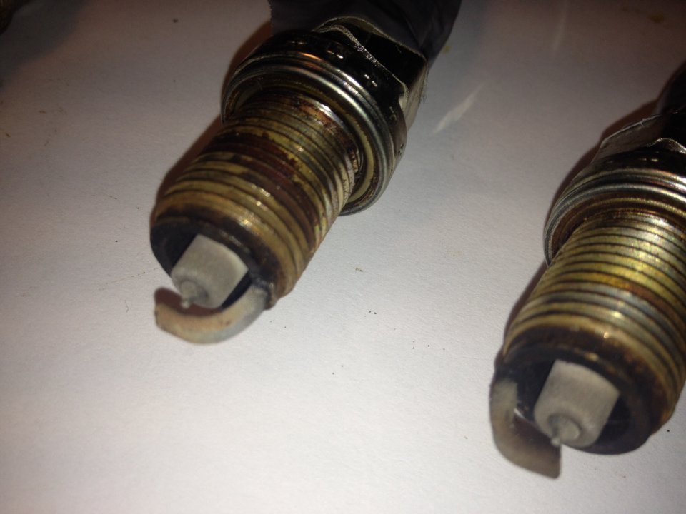

    Changed all spark plugs today, bit of a challenge getting the plugs out, after they were loose.I think they make a special spark plug socket that helps hold the plug in the socket on the way out. I used a piece of clear tubing to push onto top of plug and pull out. Plug gaps were not too far off, goes without saying, new plugs make a difference. Below are two of the four plugs.

    Sounds goods joe. Those plugs didn't look too bad. Hard to tell if they were replaced on schedule (about 120k miles) or if they're original, those iridium plugs hardly seem to wear much.

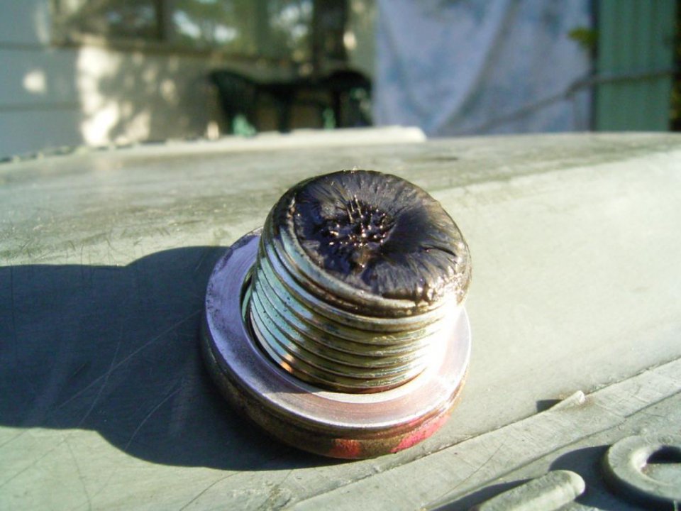

    Yeah I'll bet the fluid was original. With the high cost of transmission repairs it was absolutely the best thing you could do for the car to change that out. Did you happen to notice what the drain plug looked like when you removed it? There's a magnet on the inside and you can tell a lot about the health of the fluid by looking at how much gunk it's holding. You don't (or shouldn't) see metal particles as such, but it does tend to accumulate a ferromagnetic greasy sludge like this:

    I think I would have noticed if there was anything on the magnetic plug.
    Could have been a little. good point. I think I will change fluid again every 30k

    Yes, in the future you could use a 5/8" spark plug socket that contains a black rubber insert to hold the spark plug in place and also reduces the chance of damaging the porcelain tail.
