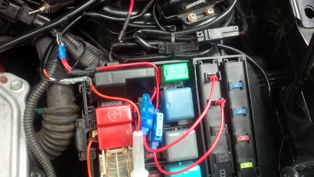

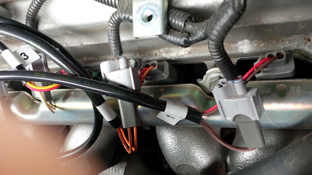

    I have some pictures from the installation of the so called "ecobox E85" (about $220).
    Ground for the box and my Daytime running light:
    Fuel Injectors:

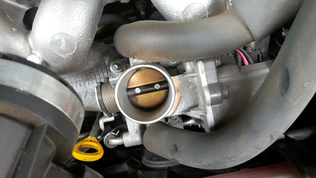

    Throttle damper:

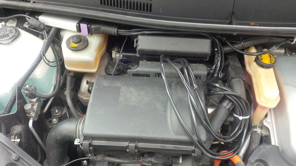

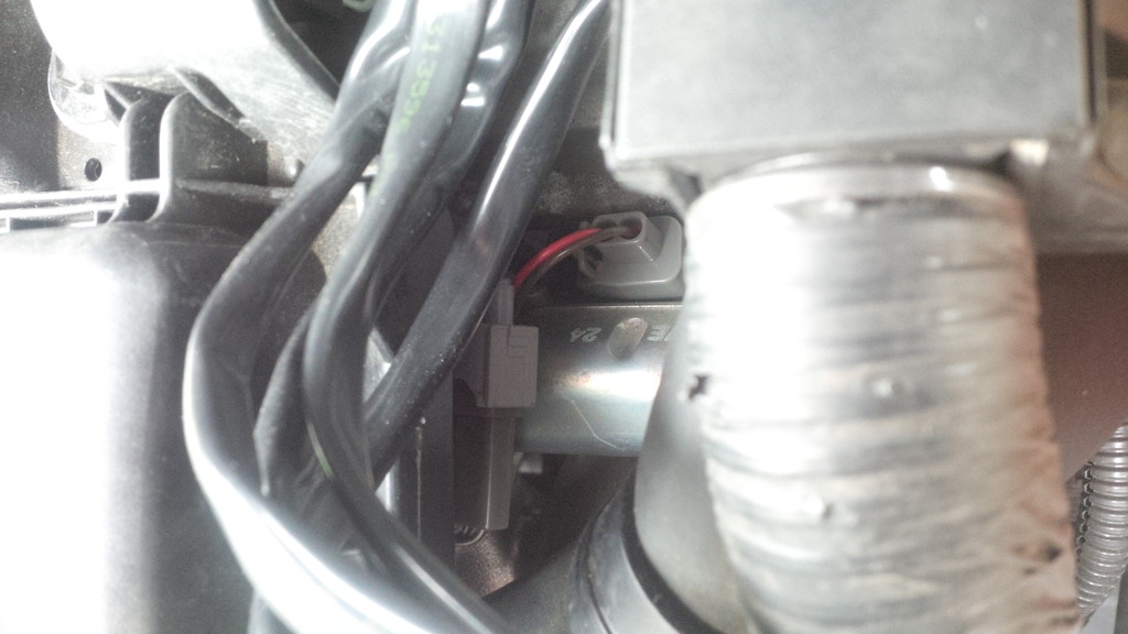

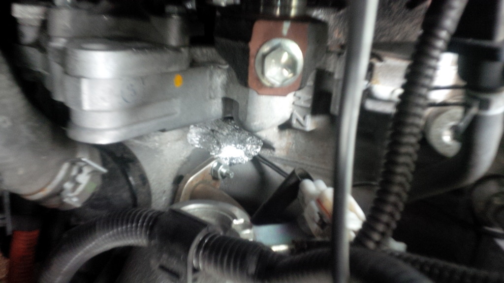

    The box has a sensor that monitors the temperature. If the engine is to cold (e.g. cold winter), it enriches the fuel automatically as much as you have set before (e.g. 40%). The sensor is installed between the water pump and the engine with aluminium foil.
    You can deactivate the box with the little switch on the left. If you are using Regular Gas.
    The box. Now i have fixed it better.

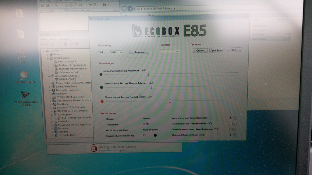

    And the software (in german):
    You can set:
    Enrichment during engine start under 57 degrees. I have set 60%
    Enrichment during engine warmup. I have acutally set 35% for 2 minutes. The engine must be colder than 75 degrees.
    And finally enrichment while the engine is running. I have acutally set 30%.
    While driving about 75 mph straight i have an LTF of 4.5. While climbing hills on the motorway or going 100mph, it can go up to 8 - 11.
