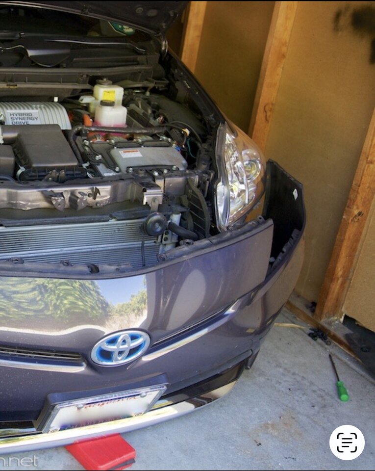

    I need to replace the front headlight, and on YouTube I’ve seen a few tutorials that show you have to remove the front bumper etc.. isn’t there an easier way? thanks for tips!

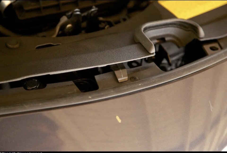

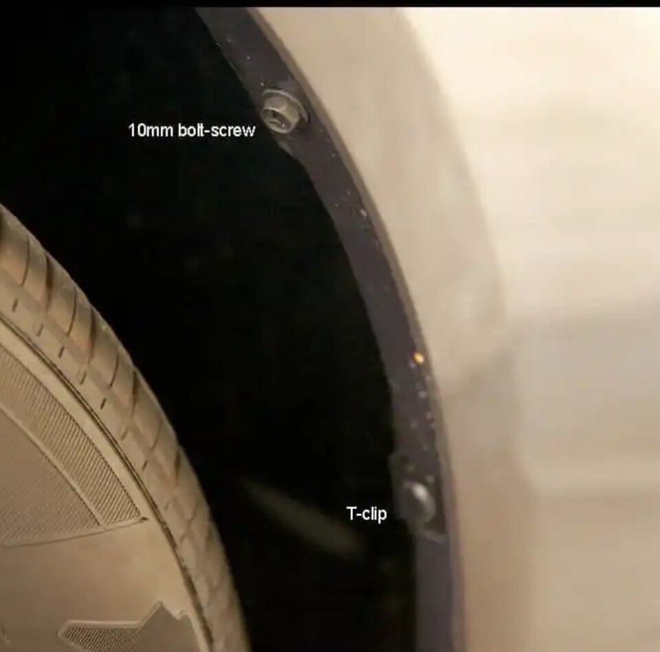

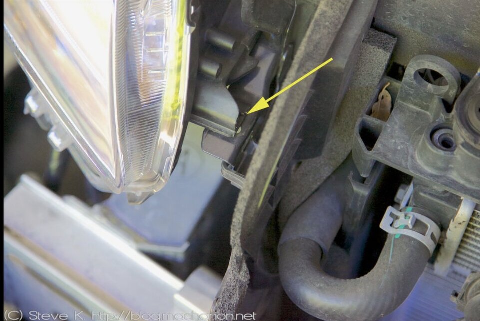

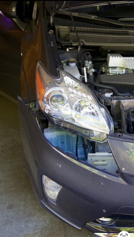

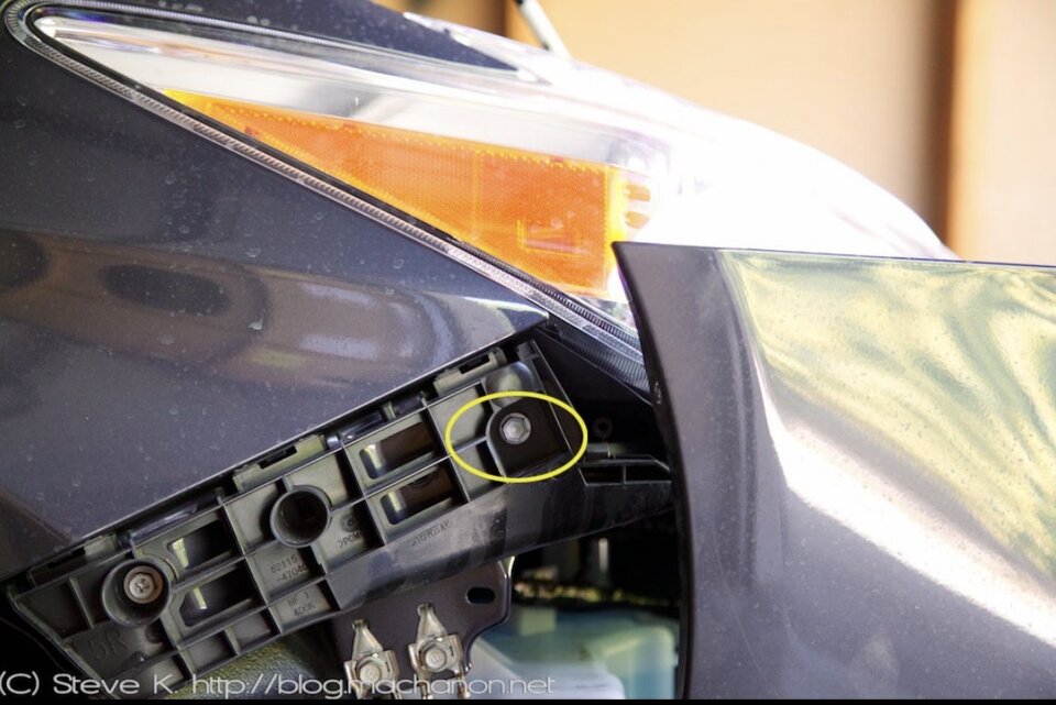

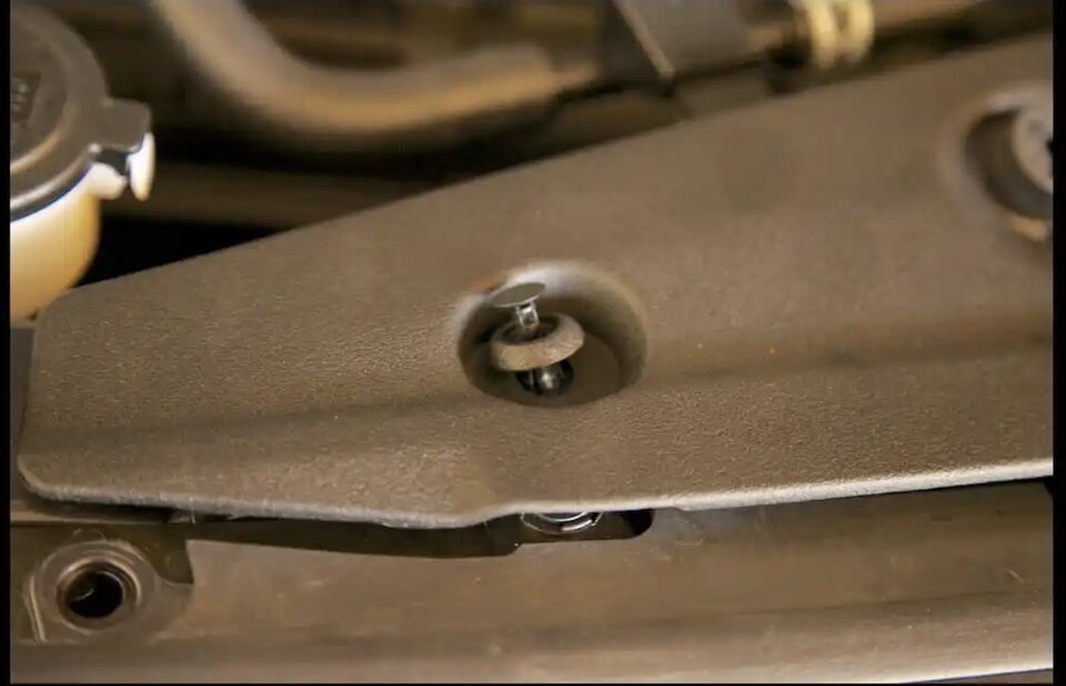

    I guess the aftermarket finally picked up the LED setup very cool . 2500 to light the road lawdy. On regular gen3 you undo screw in fender well like gen2 and ya tweak bumper cover out n forward n down allowing headlight to slide forward n out of car . I hope one is not doing this for bulbs.
  4. Mendel Leisk
    60,578
    41,735
    Repair Manual concurs. For your info:
