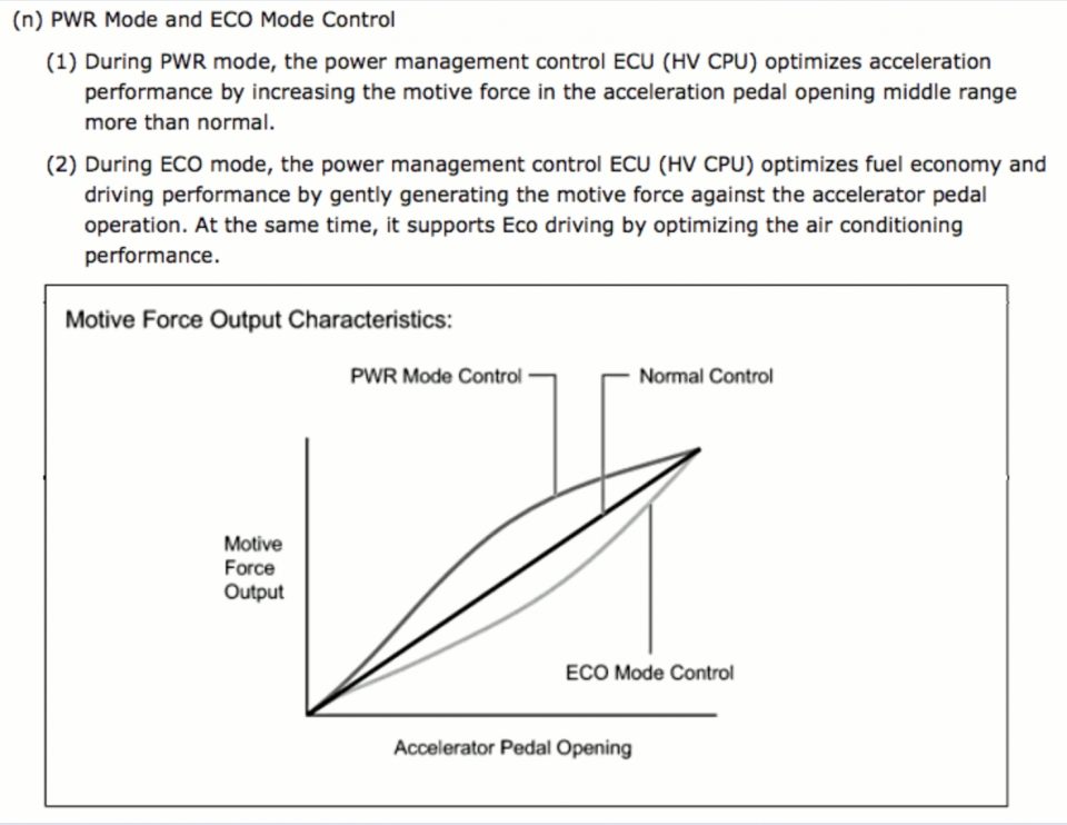

    Their picture shows it more clearly than the words:
    Your go pedal is essentially a game-controller input for telling the car how much go (torque or motive force) you want.
    With neither ECO nor PWR selected, the game controller has a linear response. Push the go pedal this much further, get this much more go.
    Select PWR and you get a curve that's concave down. Extra steep where you first go on the pedal; your earliest pedal push asks for a lot of go. This curve has to bend over later to meet up at the same max power as the straight line. Your last few mm of pedal pushing don't make as much difference in this mode.
    Select ECO and it's the reverse, a curve that is concave up. Your earliest small motions on the pedal don't request a lot of go; you have to press further for that. Here again, the curve has to bend and have the same max power point as the other two. In your last millimeters of pedal push it is responding extra steeply to catch up.
    In all the modes, the car generates the requested amount of go in the same way; there isn't one that's harder on the car than another (except indirectly, if the modes influence the way you tend to drive).

    Great explanation that explains the facts not beliefs. Thank you.
