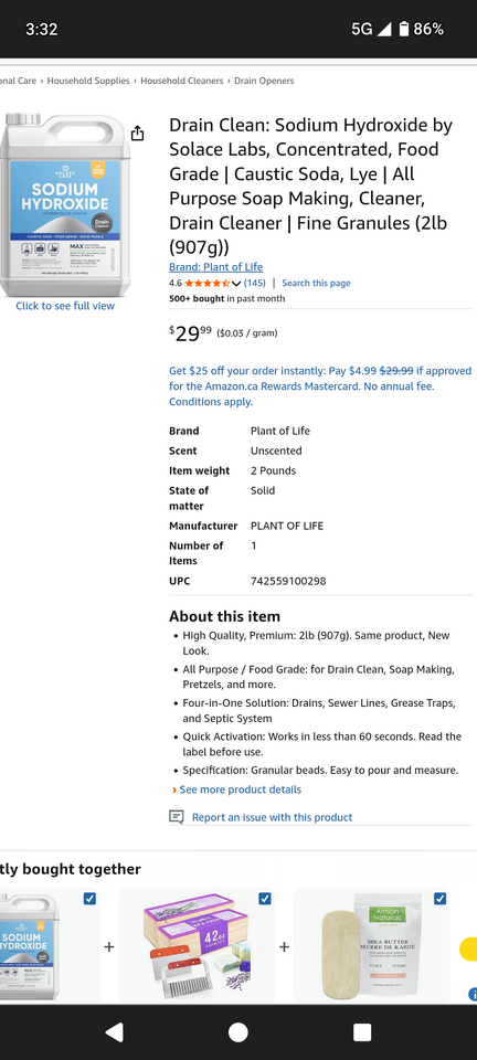

    I'm going to be doing this the first week of June. I have all my parts from Toyota and I'm just about to order my tools and cleaners.
    Does this lye look right?
    If I use the rubber stopper for the cooler and soak it with this mixed with water will that clean it out?
  15. Mendel Leisk
    61,189
    42,062
    That’s the stuff. Read up on how to mix, safety precautions. You always add lye to water, not the other way. Use cold water, it’ll react and heat up. You’ll need about a cup of water to fill, say 250 grams, then add the lye. I’d try 125 grams lye for starters. I believe saturated solution would be equal weights.
    only use on the cooler. The pipe is also stainless, but trivial to clean. Anything not stainless steel you don’t want to use lye. Don’t use on intake manifold either, it has ferrous embedded bits.
