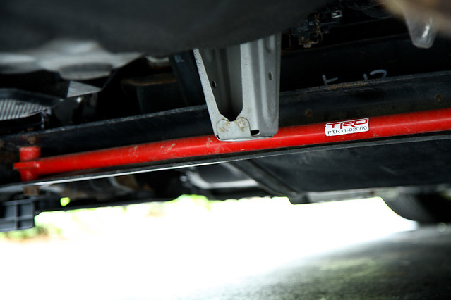

    For the sway bar you won't see as much difference as the springs but.. It's relatively inexpensive and is simple to install. I just used the existing bolts and swapped it out (although I don't think I reused the bushing)
    If anything, it just looks really freaking cool because it's TRD red and you can see it if you're behind me in another car. I can post pictures tomorrow

    The car handles well now but a little better handling wouldn't be bad. The bar is simple to install which is why i've been eyeing them for awhile. If you can post a pic i'd appreciate it. :)

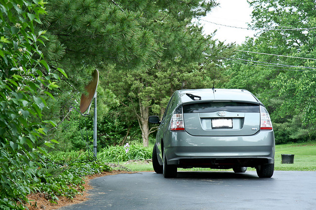

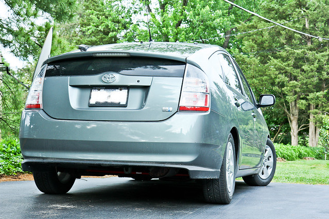

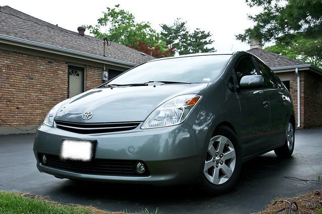

    Hey F8L, got some pics of the sway bar and also overall my car because i'm vain. but i guess it shows off eibach springs too.
    It's a little cloudy today so it's doesn't show up well underneath the car. But if a car has headlights on and shines on the bar it really pops :)

    Thanks, flareak! Your car is so clean and that scenery is so lush. I'm a sucker for botany. :)
