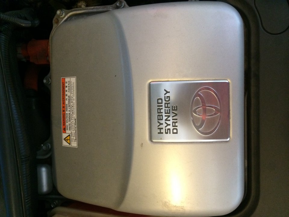

    It sounds like it's coming from under the silver cover - what's under there?

    The inverter water pump is under there, which is a recall item from Toyota.
    If you take the cap off the inverter reservoir, you should be able to see turbulence in the coolant when the car is on. If you don't see turbulence, the pump is not working.

    "It sounds like it's coming from under the silver cover - what's under there?"
    There are no mechanical moving parts under the silver inverter cover, only electronics.
    I think it is likely that the brake actuator motor (mounted on the firewall) is the source of the noise. What warning lights are on?
