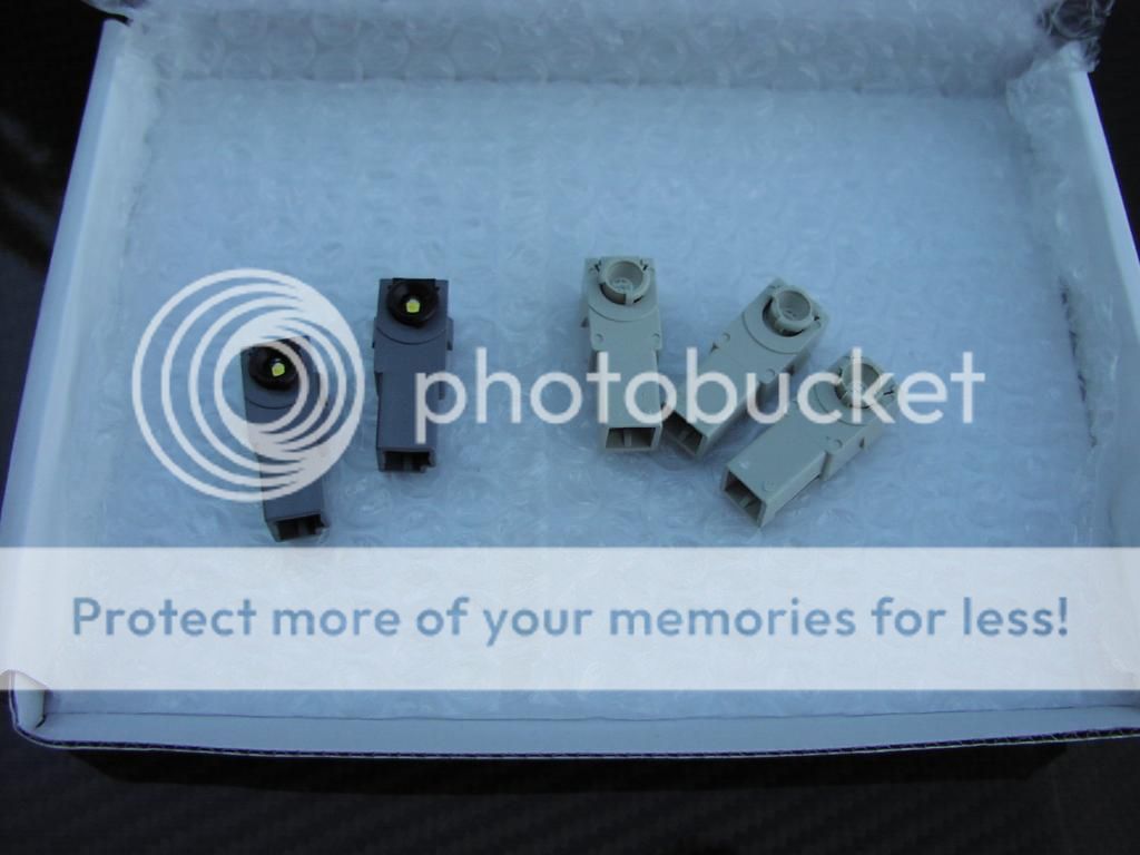

    They clip in to the two plastic panels under the dash. Two 8mm screws on the driver side and the passenger panel just kind of clips in. I removed the Lexus ones for the blue aftermarkets during my 10 min break at work. Bought a few extra blue ones to add to the rear and center console.
    Here a pic of what the footwell lights look like. Lexus white and the blue ones on the right.

    It took just over a week to receive them. They're fast with their shipping.
    As for extras, that's up to you. But a least one, just in case you get a bad one or if one goes out later. (I order 6)
    And don't forget your glove box uses the same light. If you wanted to change that one out also. I left that one white.
