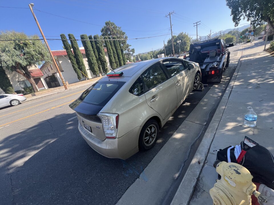

    IMG_7867.jpeg My phone rings yesterday, my son in Los Angeles. The beloved Prius has died on the side of the road.

    Then he called. 45 minutes north of Santa Clarita on his way to Sequoia National Park....
    At first I was mad- What do you mean you were taking this car up the freeway at 80mph on a 95 degree day for a 3 1/2 hour jaunt?!!?
    Then I was sad as I knew it was the end of the line.
