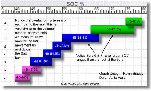

    Under certain conditions, it is normal for the battery display to get down to one bar before the engine starts to recharge it. With just one bar remaining, it is actually not even close to being "depleted", still having at least 40% State of Charge (SOC). See the following illustration:
    But it does not always go down to one bar before the engine starts to recharge it. There are several things, and combinations of things, that can cause the engine to start before it gets down that far. For example, engine coolant temperature too low, battery temperature too low or too high, HVAC temperature setting too low or too high, defroster setting, catalytic converter temperature too low, and maybe some more parameters that I am not aware of.
    Rick 432 likes this.
