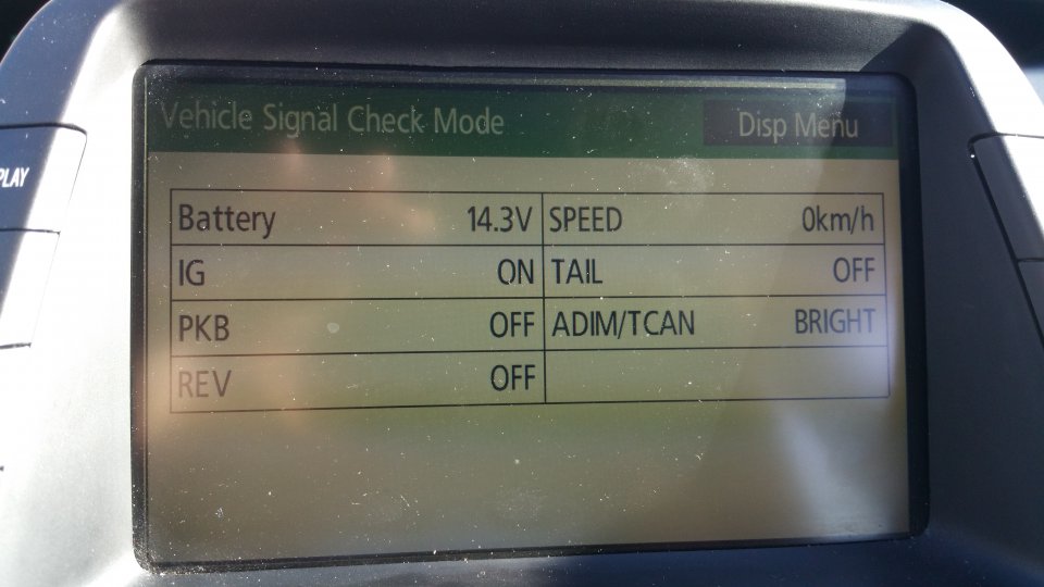

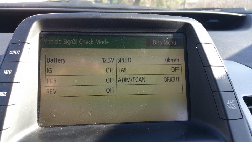

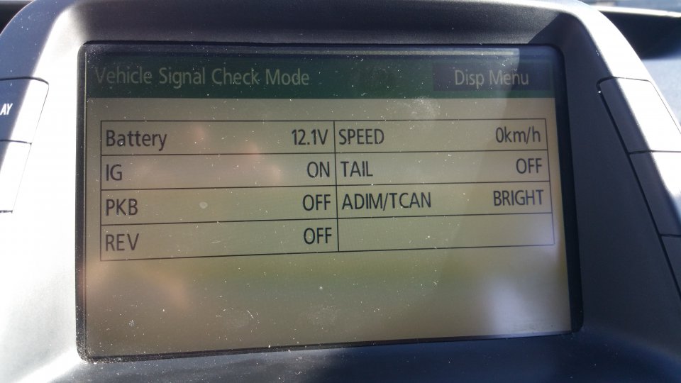

    I checked the status of the battery first thing this morning and it's good to go. 12.3V and that's with dual dash cams (Front and Rear) running 24/7 off the 12-Volt battery. 2015-03-30 10.12.21.jpg 2015-03-30 10.12.42.jpg 2015-03-30 10.13.25.jpg

  13. mike091020
    mike091020 Junior Member
    Mar 23, 2012
    49
    24
    Maryland
    How did you get this display? Is there some kind of magic button combination to push? ;--)
