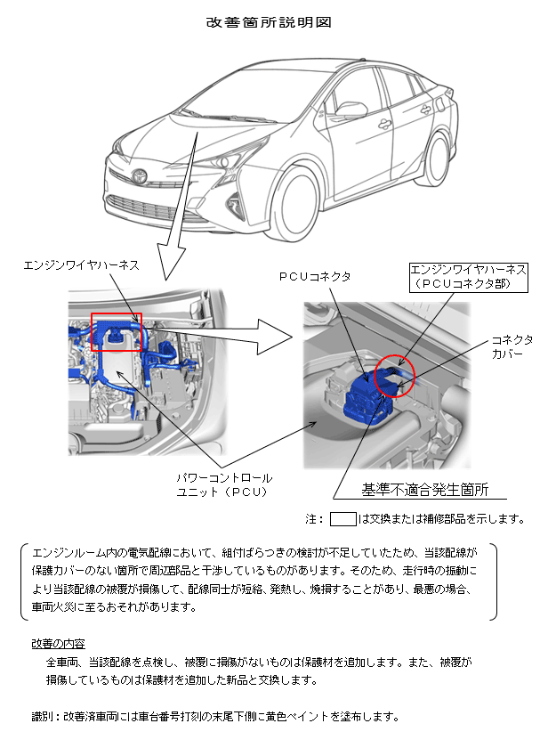

    The work instructions will eventually be posted on NHTSA’s website. There’s nothing there or on the Japan MLIT recall page yet, but Toyota’s website in Japan has an announcement and illustration with a few more details (all pages in Japanese).
    The key repair information will be the parts of the wire harness to inspect for damage, the kind of tape to use, and where and how to apply it. You can get a general idea on the first point from the illustration from Japan: the red circle, near the low-voltage connector on the top of the inverter with converter assembly (labeled “PCU,” power control unit), highlights the area of possible failure.
    UltraJetRefill and Mendel Leisk like this.

    Thanks to Google Translate Japanese to English:
    NOT sure how to read 'Target Vehicle section Paragraph 2 and 3...
    Picture was a graphic .gif and did not translate... but shows location.
    Recall of Prius, Prius PHV, C-HR
    Report number 4327
    Recall start date September 6
    [​IMG] Regarding parts of vehicles of Prius, Prius PHV, C-HR produced in Heisei 20 through Heisei 30, Heisei announced the recall of the following contents to the Ministry of Land, Infrastructure and Transport on September 5,
    We regret to apologize for any inconvenience, but we will guide you from Toyota dealer so we ask that you inspect and repair.
    Whether the customer's favorite car is the target vehicle or not can be confirmed by recall etc. information subject vehicle search .
    [​IMG] [​IMG]Improvement location explanation drawing
    [​IMG] 1. Problem status
    In the electrical wiring in the engine room, due to lack of consideration of assembly variation, there is a wiring that interferes with peripheral parts at a place without a protective cover. As a result, the covering of the wiring may be damaged due to vibration during running, causing short-circuiting between the wiring and heating, resulting in burnout. In the worst case, there is a danger of vehicle fire.
    2. Content of improvement
    Inspect all vehicles, wiring concerned and add protective materials for those with no damage to the covering. Also, if the covering is damaged, replace it with a new one with added protective material.

    Here is a picture of what is depicted in that Japanese diagram. There is tons of gap so I’m not sure how it could possibly rub.

    The announcement from Japan refers to 組付ばらつき (assembly variation), so it may well be that your car and mine don’t exhibit the problem. Perhaps the wire bundle from connector C33 (the rightmost of the two connectors on top of the inverter with converter assembly) wasn’t always placed in the same way as it enters the protector.
