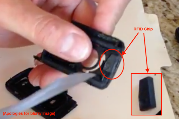

    It is possible that you received a fob with a new shell and the original parts put in it. Maybe they forgot to move over the RFID chip.
    Does the key start the car if it is inserted in the slot?
