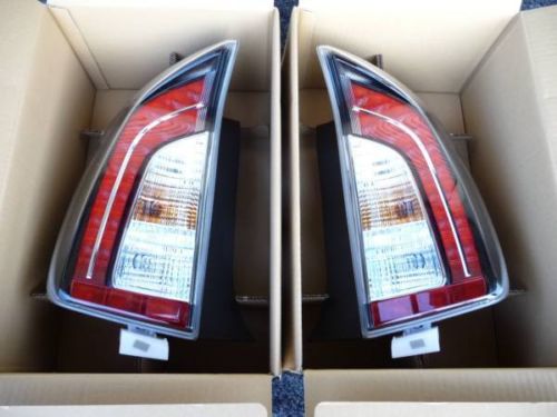

    The rear fog light in European versions is integrated into one of the reversing lights (depending which side of the road the car is driven on). It's hard to see this in the pictures as the lens is still white on the outside.
    You can just about see it on the picture of a UK RHD Prius. The right hand side rear lamp has a red part at the bottom. A LHD version is the reverse.
    Now you can try and change your rear lights to a European version with the fog included but you then have the fun of changing the wiring and installing a switch. The official rear fog light switch is on the headlights like your version but it has an extra turn for the rear. Turn it once and you get front fogs, turn it again and you get front and rear, but it has a switch so that once you turn the car off the rear fog is switched off automatically so people don't forget and blind people behind them 4 weeks after the last foggy day.
    Grey imports from Japan are very popular in the UK so you won't have a job finding a modification kit that meets the legal requirements and height etc, but whether you can find such a kit in mainland Europe is questionable. You might have to cut a hole in the rear bumper which doesn't look quite as good as an integrated light.
    [​IMG] [​IMG]
    Two grey imports with added rear fog kits.
    Or you could just sell your US car and buy a local car? There are strict rules on placement and brightness and it depends on the area you'll be living. The UK are quite flexible on it but some places aren't.

    I suppose JDM version of rear light should work on US Prius as well. I've seen quite a few posts from fellow Prius owners regarding that. eBay search shows "Toyota PRIUS ZVW30 35 PHV Optional Tail Lights LH + RH set Genuine OEM Parts" for $739 +S&H. In the description, it states:
    Lamp assy, rear combination, Right x 1,(Rear fog lamp)
    Lamp assy, rear combination, Left x 1,
    I guess the question is how to wire it properly and whether this mod is legal in the streets of California :) I will check around.
    As to the cost...Prius trim II here costs around $25K with taxes. Prius trim II in Europe costs around 27K euros so that will be around $33K. Also, I would have to sell it at a bargain. Given that employer pays for relocation, I figured import option is worth considering.
