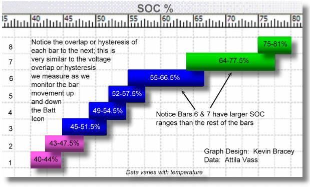

    Sometimes when the battery SOC is 1 bar from full you cannot enable EV mode. Other times you can. You see, there is significant hysteresis of the SOC of the battery. Above a predetermined threshold (maybe 70% SOC?) EV is not allowed...in the SOC 1 bar from full the SOC could be anywhere from 65%-77.5%.
