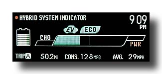

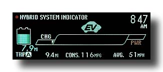

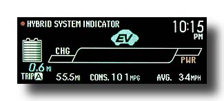

  5. john1701a
    john1701a Prius Guru
    Jan 6, 2004
    12,794
    5,276
    57
    Full happens twice...
    Notice how the first actually is more full than the second, based on the number value underneath.
    The bars indicates less and is easy to see in contrast to the solid. Also, notice now the number goes away as the bars stay...
