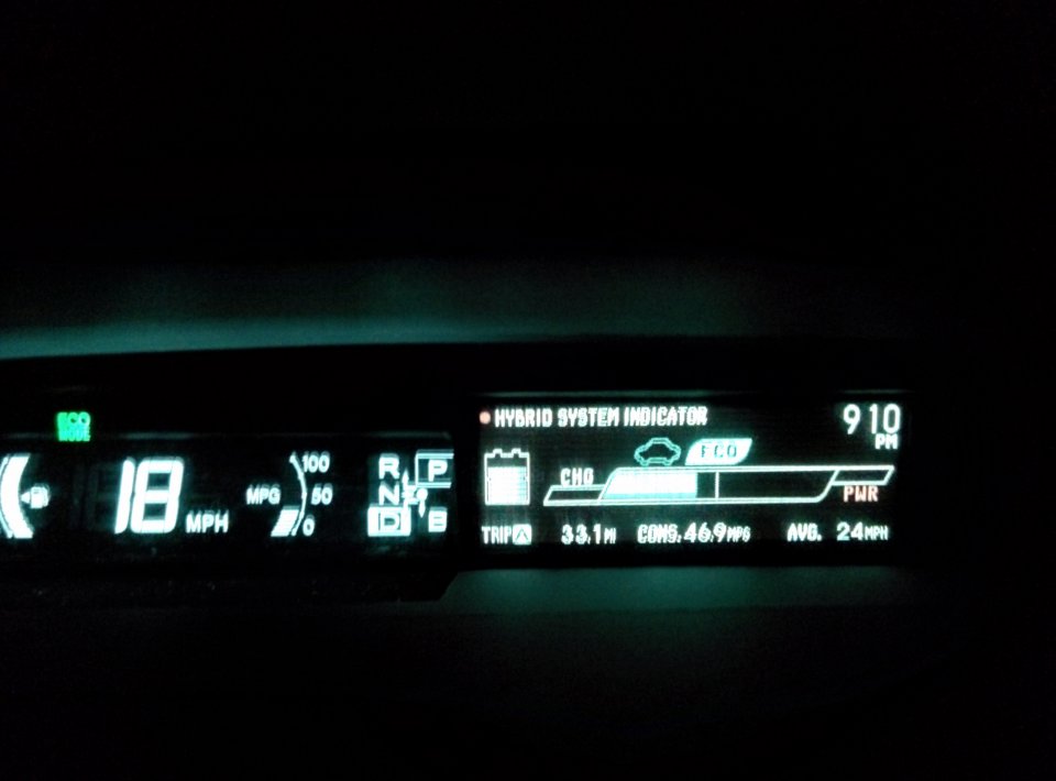

    Have a 2014 Prius III. Was getting 50-60 mpg until i took it in for the 5k mile service. Immediately afterwards the mpg dropped to 43-50 mpg. It seems when the car is cold, it will start in EV mode for a few seconds and then the engine will kick in and it will not enter EV mode for the first few miles even with the battery 80% charged, driving under 20 mph, a/c off and keeping the Hybrid system indicator in what should be the EV range.

    What is your picture showing us?

    The pic show the driving conditions which normally would run in EV mode (less than 25mpg, almost full battery, feathering the gas peddle to keep the bar in the EV range), but does not.

    I will have to check mine on the way to work in the morning. Were you in EV mode before? Looks kinda high in the ECO to be pure EV. What about the other screens? Like on the Nav unit. Does it show the ICE on?
