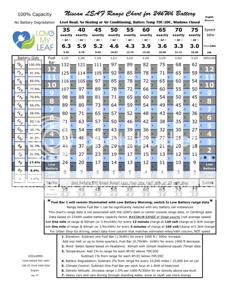

    This seems to imply that the Leaf efficiency is nearly half going 70mph vs. 35mph.

    That is overall efficiency, it in no way shows anything about the drivetrain efficiency.
    Most, if not all of that is due to air resistance increasing as speed does.
