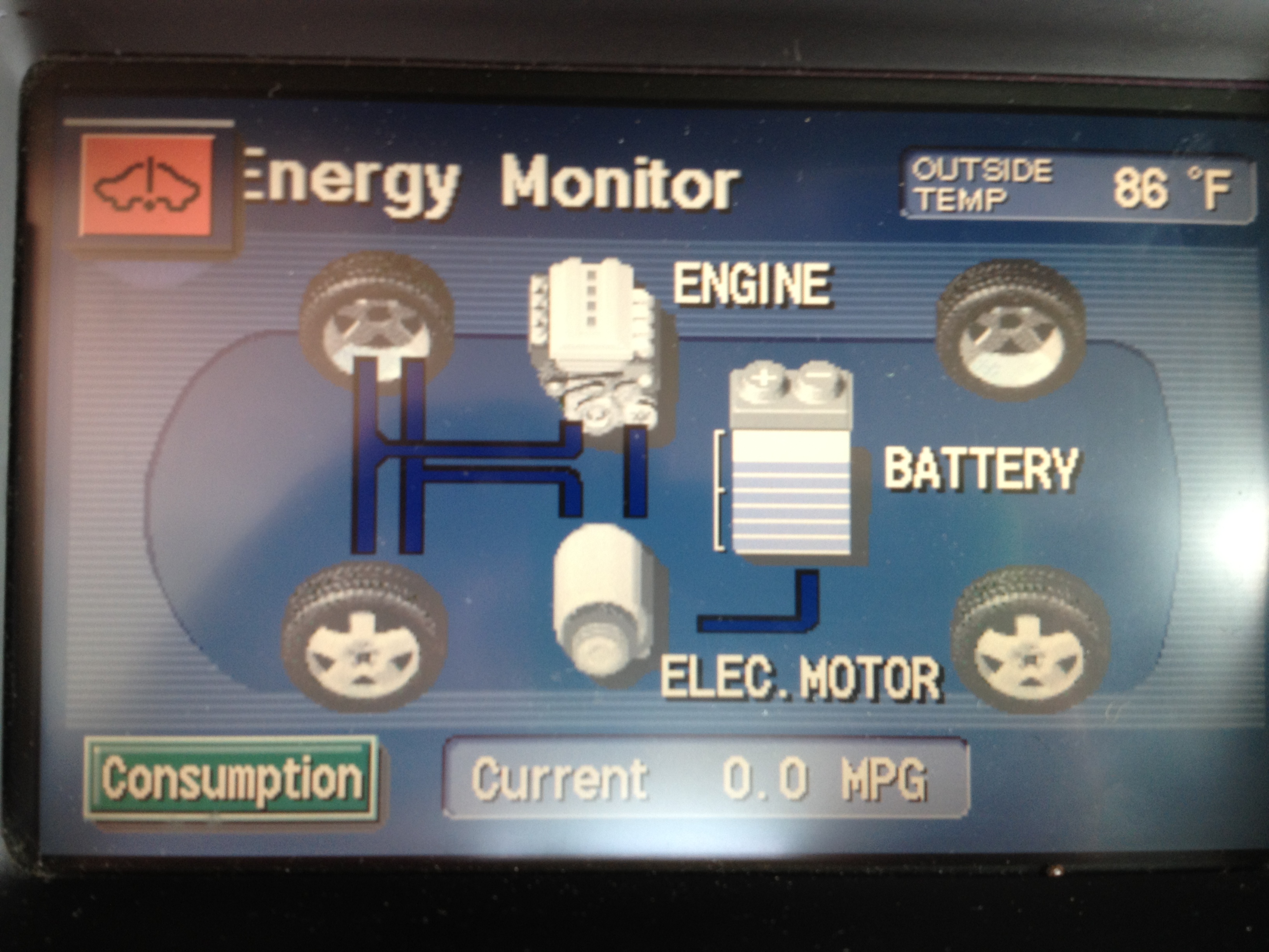

    Hello ,
    Brake pads were ok , we checked it
    marks did show up again ,
    front panel looks like this
    and LCD screen like this
    but there was not any DTC-s again ...
    but when i tried to clear ECU data lights went out , but then again appeared (just for testing)
    Battery shows 11.7V on LCD diagnostics mode
    i remember that first time when marks appeared , i was driving on a little hill and as soon as i pressed gas pedal fully , marks appeared
    any ideas ?
  11. Patrick Wong
    Patrick Wong DIY Enthusiast
    Mar 8, 2008
    18,210
    6,517
    Green Valley, AZ
    My advice in post #2 still applies. Obviously your code reader is not able to pick up the DTC, but trust me, they exist if you see those warning lights and warning icon in the MFD.
    Also it wouldn't hurt to replace the 12V battery, but that is not causing the warning lights.
