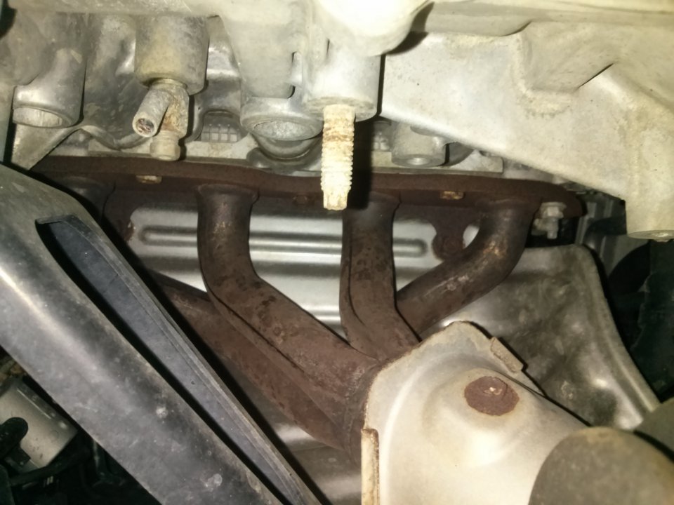

    @prius_cub here in Virginia recently reported his manifold upstream of the muffler was rusted thru...think he DIY'ed a fix ..he posted some pics.
    Have not heard too many cases but I guess winter salt could be a culprit.
    2008 Loud Engine Noise | PriusChat
