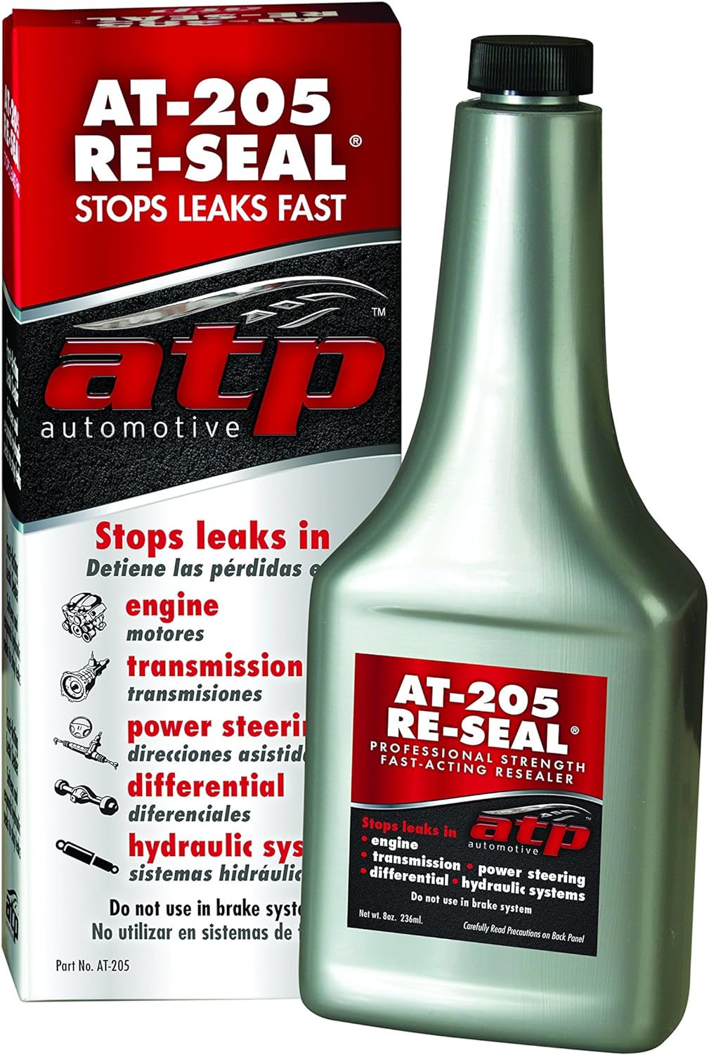

    Guys, I solved the oil leak on crankshaft seal with this product, AT-205 Re-Seal from Amazon at $9.59!!!
    My 2013 Prius V has 185,000 miles and use for Uber/Lyft. No more oil leak with this product.[​IMG]

    Why I always buy new...
