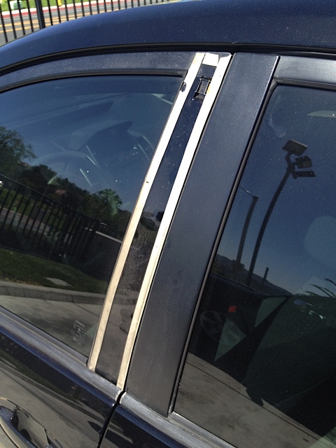

    While driving my 2005 on a trip up to San Francisco, my wife said she "heard something flapping" and looked into the mirror to see the exterior trim fall off.
    It looks like the double sided tape was no longer sticky, and the plastic piece that actually clips in on the top broke. Some initial internet searching has left me without any OEM style options, the only one I can find are high gloss aftermarket ones that wouldn't match. What would you all recommend to find a replacement? I've called around, and surprisingly, I haven't found any Prii in Los Angeles county junkyards.
