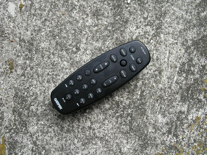

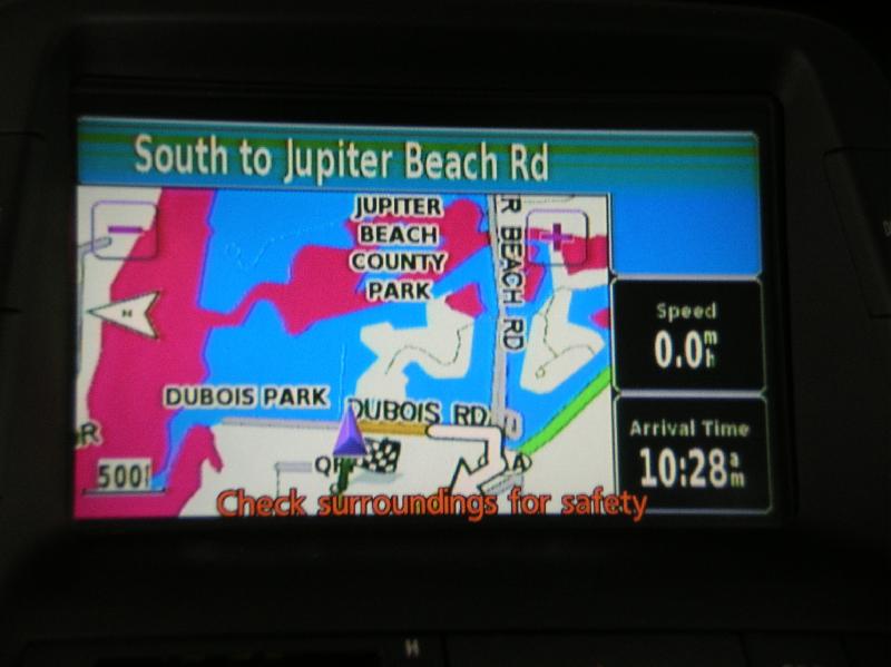

    OK, it works!
    It comes with a remote control to control all the functions:

    I need to use it a lot more to say definitively, but it seems just as easy to read as the C230 I rented last week. The screen is MUCH larger, of course. So, even if the resolution isn't great, its still fine to read everything.
    The remote takes some getting used to, and is definitely not as easy as the touchscreen I used last week. Its pretty intuitive, but much more time-consuming, since I can't just hunt-and-peck in an address. I've just gotten used to the idea of making sure I put the destination in ahead of time, as trying to do it on the road would definitely be hazardous to my health.
