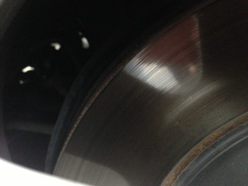

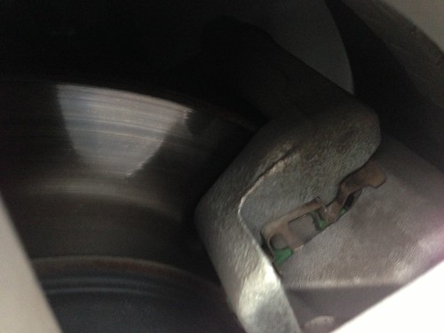

    OK your welcome. Not necessary to remove the rotors as that is a pain but they may be really bad. Take a picture of the rotor and post it. Lets see how bad it is.

    I will start with looking at this because I think I remember seeing a sheen of rust on the rotors but I am open to any suggestions as to what to look into.

    Here are pictures of my rotors.

    And I wish the brakes on my old nonhybrid where that clean.
