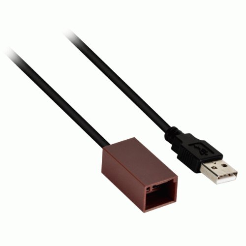

    The Sony AX100 gives you a USB female pigtail:
    I bought the Axxes usb adapter:
    However this adapter, adapts the harness side to a USB A Male, what I want is the Port Side adapter to a standard USB port
    Does anyone know if there is such an adapter or has anyone tried to find the physical connector part number? Then at least I can make my own connector. I'm avoiding cutting connectors because it's just my nature to make sure everything is clean and reversible.

    The armrest/center console USB port has the following physical architecture
    USB/aux port > harness extension to front of center console > harness connection to head unit
    The extension cable I originally linked to in my OP is the same connector as the USB/aux port connector which means it can interface to the harness section from the radio, rendering the factory usb/aux port jack useless.
    What I wanted to do is retain the factory USB port and get a converter/adapter from the factory center console extension to a standard usb 2.0 manual connector.
    This is the rear of the removed USB/aux port
    Also the other connector the other poster linked to is a different toyota USB adapter. I have bought and returned both. That one is a square connector where as the brown one is rather rectangular.
    It’s just 4 serial lines so I can always run a harness in between but I wanted to avoid that. I like leaving the factory harness in place and finding the actual pin and connector housing.

    I decided to intercept and split the intermediate factory harness. This is the section that runs underneath the center console from the port to the main harness that connects to the head unit at the front section of the center console.
    So i cut up the original intermediate and used a molex 4 pin connector, that way in the future if I decide to revert back to stock, I can. Now I have a molex section with a USB 2.0 male that goes to the headunit
    I also purchased an additional intermediate factory section just in case it bothers me that I cut the original and split it into 2 sections.
