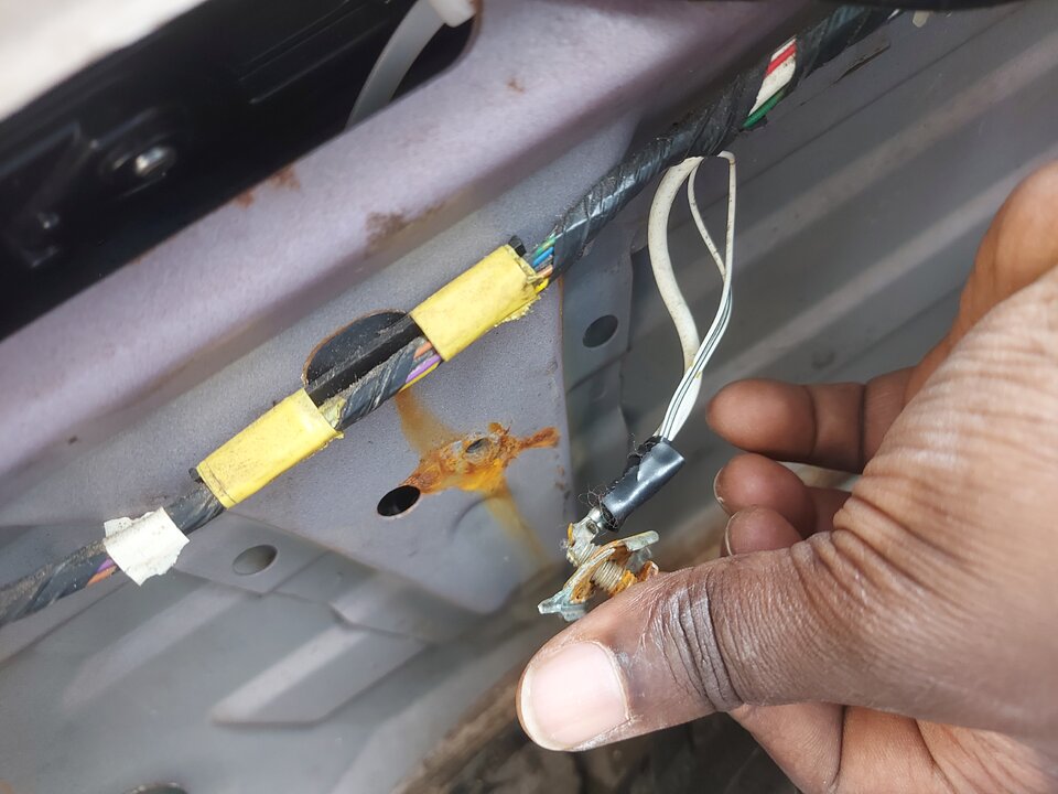

  13. k1ngn0thing
    k1ngn0thing Member
    Sep 7, 2017
    205
    48
    MA
    2016 Prius c
    the solution in my case was the ground near the spare tire
    Phil Stasik likes this.
  14. Phil Stasik
    Phil Stasik Junior Member
    Nov 18, 2015
    48
    Merritt Island, Florida
    You guys are so awesome! I have saved so much time and money over the past 9 years with the good advice from this site! My sister took her 2004 Prius (that my wife and I originally bought new) in to the local tire place, and had EXACTLY the same symptoms that scottlay originally posted. The problem was exactly the same. The tire guys dropped the spare in to the storage area sloppily, and broke the turn signal circuit ground wire that is normally crimped onto a washer on the rear side of the tire storage well. It looked EXACTLY like K1ngn0thing's photo. Easy fix. Damn!
