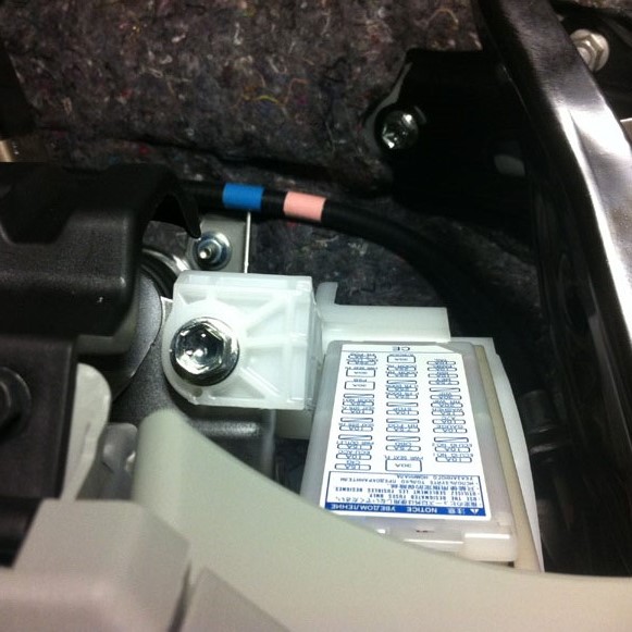

    (Sorry, iPhone pics want to stay upside-down.)
    (OEM setup)

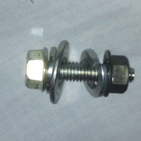

    If you don't have such a nut, you might have to go to a hardware store and test fit the bolt until you find a compatible nut. If you must go to the hardware store, consider getting a correct pitch bolt that's longer than what is on your Prius. You can't see it in these pictures, but the end of the bolt is tapered. So, you really don't get that last 1/8 inch to work with.
    For this fix, I found a compatible nut, a washer for the front (in addition to the one on the bolt) and a lock washer for the back nut (to ensure it would not come loose). I ended up not using the lock washer because the bolt (thanks to the taper) was too short to get the nut on. Tightening it all hand snug should do fine. It's not put on all that tight (the mounting bracket being plastic and all that).
    (Unless your Prius is named "Houdini," this isn't coming off)

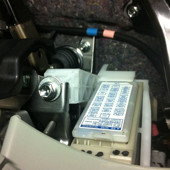

    Move the fuse block to the side and push back so that the bracket is BEHIND the metal mounting brace. Run the bolt with washer in, and as it starts to emerge from the plastic bracket, start getting the nut on. It's a bit of a contortion to get any tool back there, but you will want to do more than use just your fingers to ensure the nut is tightened down.
    (Who knew 1/2 an inch would bring so much satisfaction)
