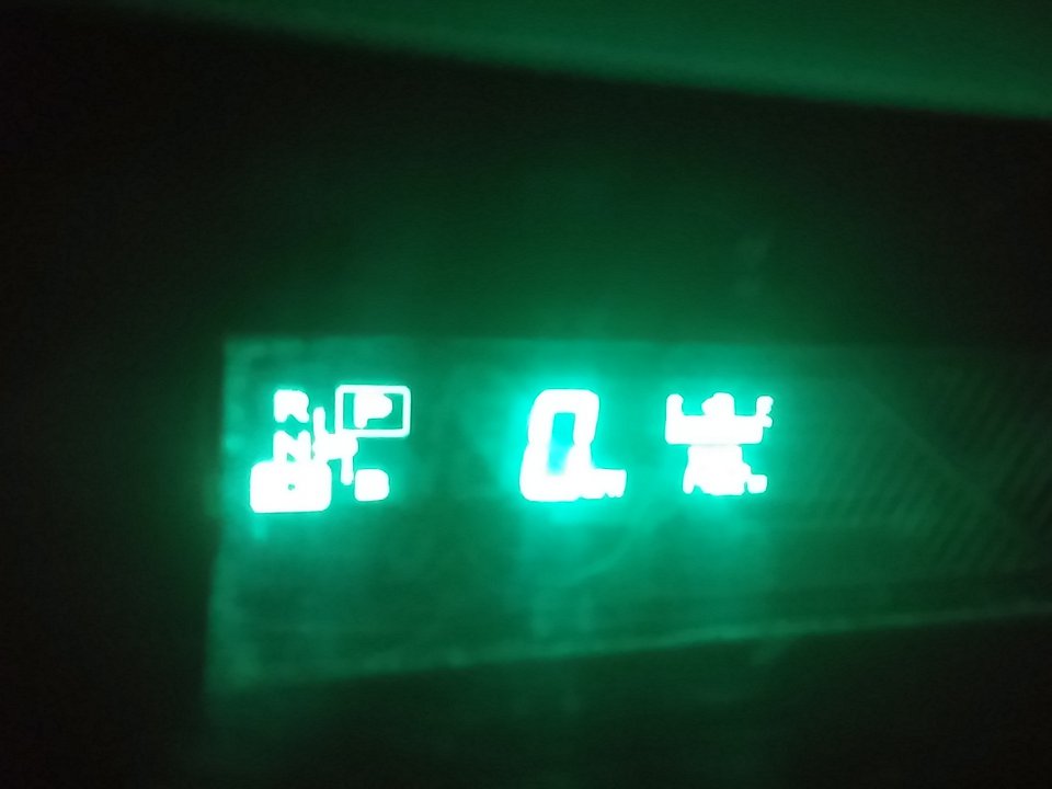

  7. fileaudio
    fileaudio Member
    May 23, 2014
    109
    58
    El paso texas
    Well and a bar is gone now,,, i guess my conclusion is that it gets better mpg than my previous honda civ hyb, 20141026_185550.jpg
