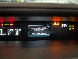

    So I had previously posted back on December of 2024 that I notice my brake booster//pump starting to run every 30 seconds or so. Well today it finally lite up the "Christmas tree" on the dash. We were driving down the interstate and I had cruise on and it disengaging and started flashing/beeping. Got home and the brake booster/pump is now running every 3 seconds.

    Naturally, don't clear any trouble codes or try to reset anything.
    But it would be good to look at what trouble codes you have. If you haven't got a scan tool that can show them, you can use this method:
    Blink (a/k/a Flash) Codes – How to. | PriusChat
    The 23TE07 program only applies if you have certain specific trouble codes. The "PRE-COLLISION SYSTEM" warning showing on your MID would explain cruise disengaging and probably has trouble codes too, but those would be different from the ones relevant to 23TE07.
    If you pull the codes yourself and confirm they do or don't qualify you for 23TE07, then you don't have to have blind trust in the dealer to make that call for you.
