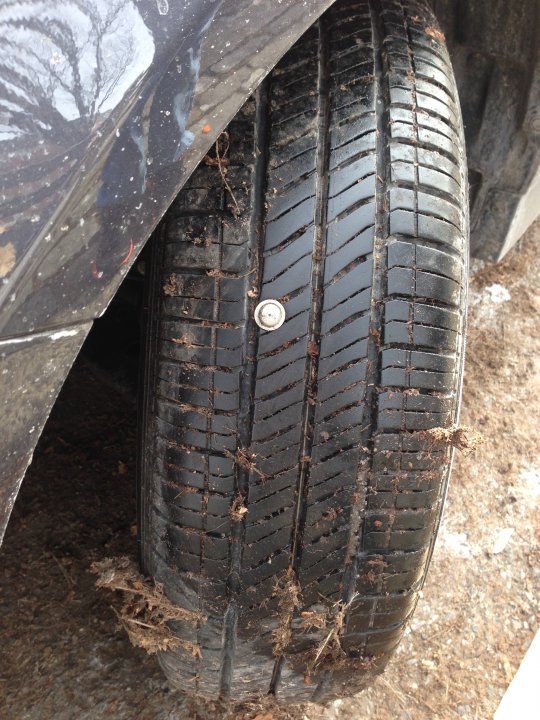

    I have similar issue since ....yesterday: more pronounced flapping -more like a knock at every rotation. The higher speed, the faster/louder knock @ driver front wheel. Prius s only @ 12K miles. We have had quite salty winter in NYC!
    Does my wheel bearing need to be looked at? Thanks!
    P.S. I do not see anything stuck in the tread or any bulging on sidewall.
    P.P.S. I just realized I posted in a C thread, my bad:(

    A wheel shouldnt knock so get it looked at if you're not confident enough to investigate it yourself. It's rare but you don't want the wheel falling off or the tyre blowing out on you!
    Generally I'd check to see if any nail or screw or even a stone is stuck in the tread. Rotate all the tyres carefully. Sometimes it can be very obvious, other times almost impossible to see unless you're looking close.

    Pliers+Tire Plug= Knockin no more:)[​IMG]
