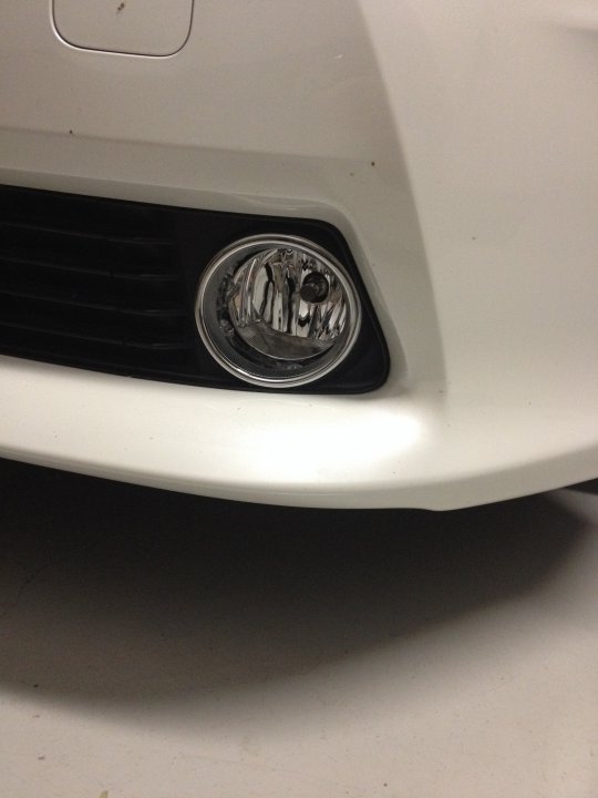

    My left fog lamp took a rock today and broke the glass. The bulb and the surrounding area are undamaged. It was ONLY the glass. Whats the best way to get this replaced asap?
    1. Get the part and tackle it myself? Degree of difficulty?
    2. Take it to the stealer?
    I believe I need part # 81220-06070. It looks as if the part will cost $126.00.
    I look forward to all replays.

    Drive front end up on ramps for clearance, remove left lower splash shield, detach left fog lamp wiring harness, remove left fog lamp housing, replace with new, re-attach harness, replace splash shield, back off ramps. 20 minutes total?

    I stopped by the dealer today to get a part quote: Part # 81220-0w040, $205.32. I think I'm going to attempt the repair myself. There are 10 bolts securing the plastic skid plate which i hope will give me full access to the light. Now all I have to do is find the OEM light online. The best price so far is $125.00. More to follow soon.

    As mentioned above, you only need to gain access through the access panel below the foglight. One screw and two fasteners to remove, bend the panel down.

    I love when a plan comes together. The replacement fog lamp is in........and yes it works. Here are the stats:
    Install time: 30 mins (aka 1.5 beers)
    Price: $142.00, Amazon + the cost of 1.5 beers
    Demo: 12 bolts (10mm), 1 screw that holds the light in place and the first plastic skid plate under the front of the vehicle. I voted to remove the entire skid plate for easier access.
    Part and install quote at the dealer: $205.00 part + $120 to $150 for labor = $355.00
    Dealer: $355.00
    My cost: $142.00
    DIY savings: $213.00
    The OEM replacement light comes with a new bulb as well. This procedure would also have to followed in order to replace a bulb if needed. The light comes with 4 mounting tabs but only one screw is used. 2 of the tabs slide into a braket and the last tab is not used. The electrical connect is simply plug and play. Helpful hint. I marked all the bolt holes with tape so I could find the holes quickly (hold all perverted comments please) for re-install. The slid plate looks like swiss cheese so the tape is a big help. I don't have a floor jack or ramps so it was a bit of a tight fit but I managed just fine. If you have a broken lamp or burned out bulb go for it. I am by no means a mechanic but I do know my way around a tool box. I hope you guys find this post helpful and help take some of the "i can't do it" out of your mind.
