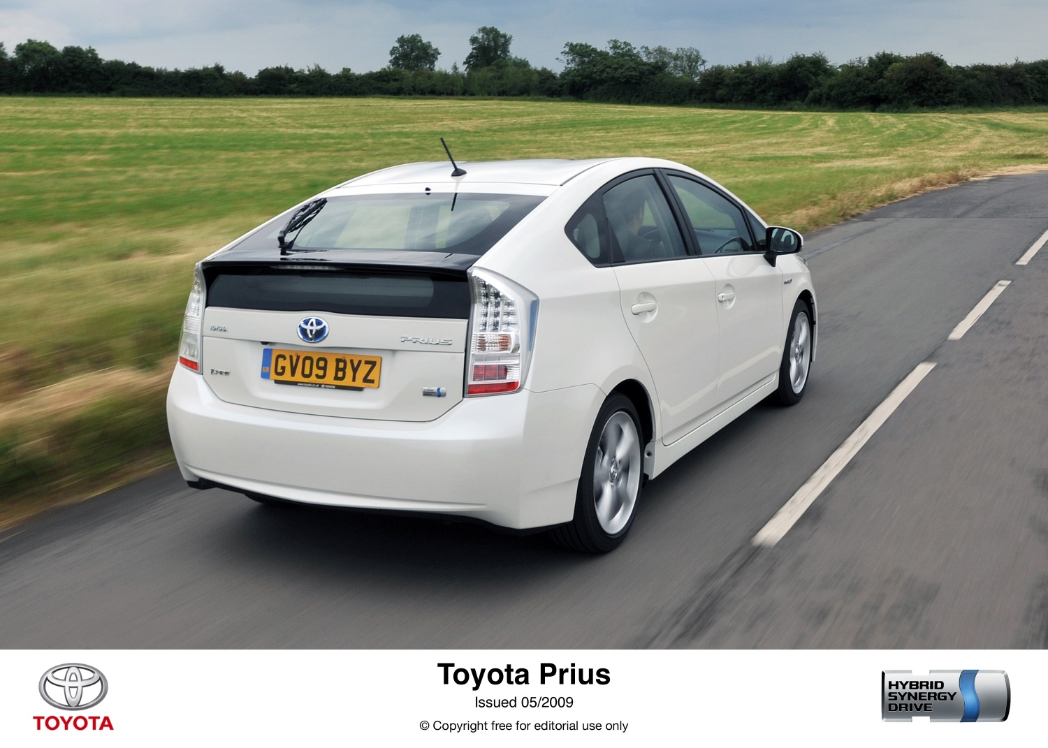

    On the Gen 3, it takes up the space of one of the reverse lights on the driver's side (so in the UK, it would be the right side). It has one rear fog
    It shares the area with the reverse light on the Gen 2. Just imagine the tail light and split it in half left to right (vertically). The outside is now the tail light and the inside is the rear foglight. There are two rear fogs.
    The rear foglight is activated by turning the front foglights on (just like on our cars) and then twisting the foglight ring one more step to activate the rear foglight (it's a spring-type position). It will return to the front foglight on position. IOW, you must have the front fogs to have the rear fogs on.
    Here's a Gen 2 to give you an idea
    Here's a Gen 3

    Thanks, Tideland. It looks kind of odd on the Gen 3. Gen 2's looks much more natural.
