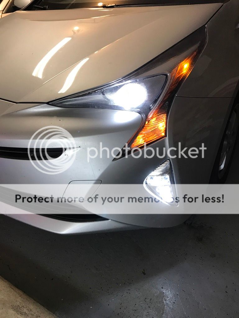

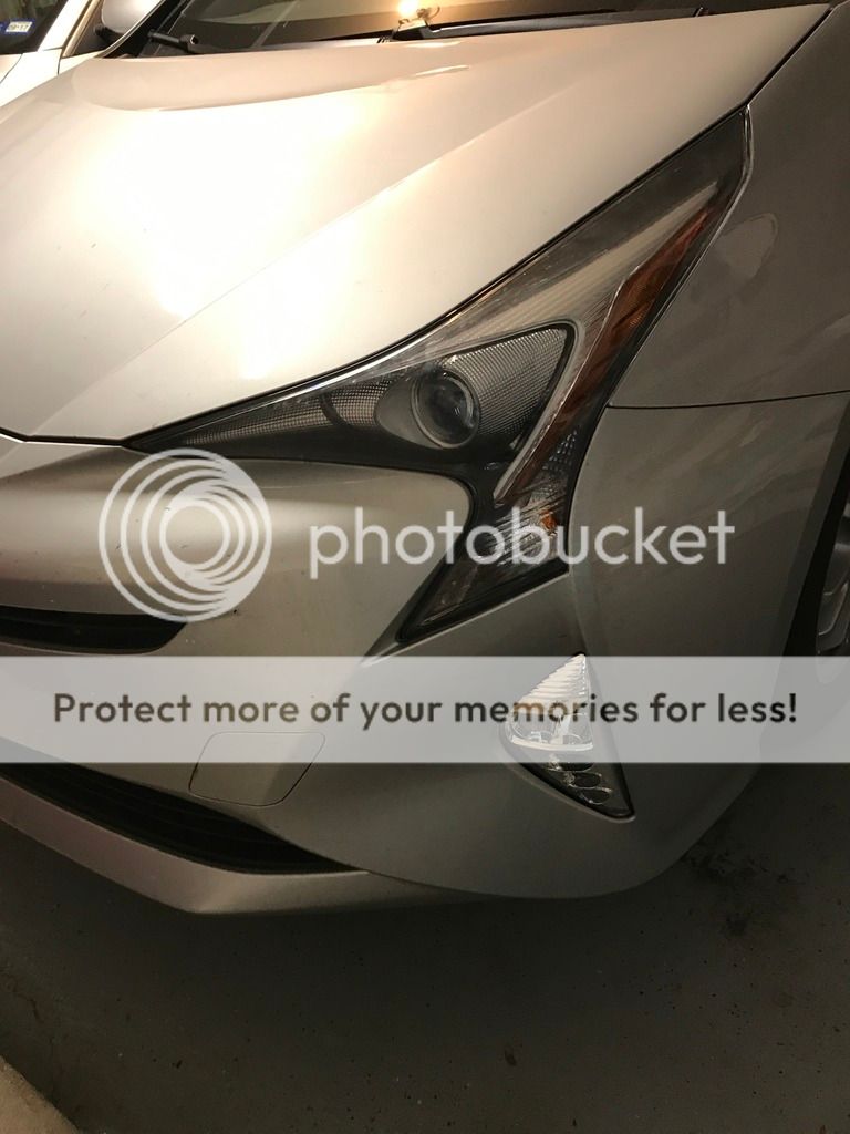

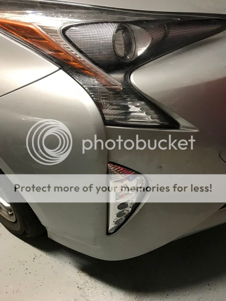

    Due to poor packaging, one of the bracket broke off. I had to JB Weld it back... all good.
    Closer look at the broken piece
    all fixed and installed. Right side. Due to the windshield fluid reservoir in the way, getting to the top bolt was a little tough but reaching from the top with the right tool, got it right in...2 minutes job.
    Left side..No problem with installation issue here.
    Light on...

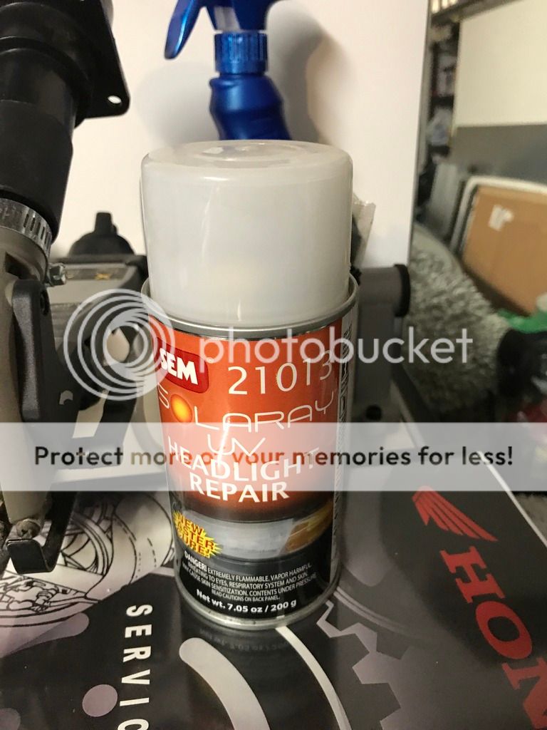

    I'm also suspecting that this cheap Chinese junk doesn't properly UV coat with the UV protectant so I will coat it with this stuffs to prevent it from turning dull.

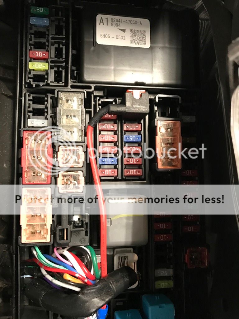

    Here is a pic of where i tapped into to get power to trip the relay to turn on the light. The light is powered directly from the battery.
